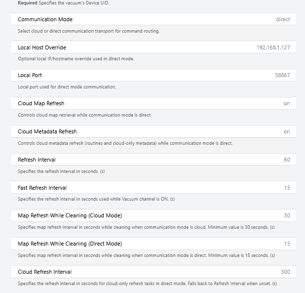

I would be also curious to hear some feedback about the exposed options. Home Assistant for instance seems to have hardcoded times for refreshing map depending on few conditions (which protocol is used, if connection is local or cloud, is robot currently cleaning and so on). UX wise, hiding options seems easier for user since amount of combinations can get bit overwhelming. Because of that, I’m not certain if exposing everything is right way of doing things but perhaps I’m overthinking. Below is pic showing all advanced options.

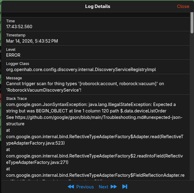

As stated in my post from August '25(yeah i know its qwuite some time), I was not able to scan for devices due to the following error:

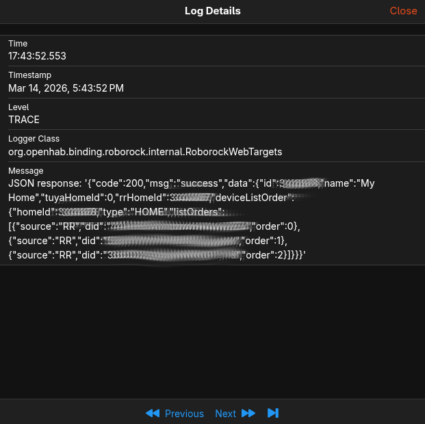

The TRACE log shows directly before the error:
so the error seems correct. but noone else seems to have it.
Since i am not a Java Person i asked Claude to have a look on the binding. It basically told me
Fix: Change deviceListOrder in Home.HomeData from String to a proper DTO class:

So i gave it a try and build a new jar file and it worked.
The error makes sense looking at the log – but nobody else seemed to have it. My theory: Roborock is rolling out a new API response format gradually, and my account already received it. The deviceListOrder field is now returned as a JSON object instead of a string, which causes Gson to throw an exception.
it is (as far as i understand) not used anywhere else in the binding code, there appear to be no side effects.
Greetings
Thanks for investigating. I’ll admit I forgot all about this. I’ll raise a PR to fix this, my solution will be simpler, I’ll just remove deviceListOrder :slight_smile:
