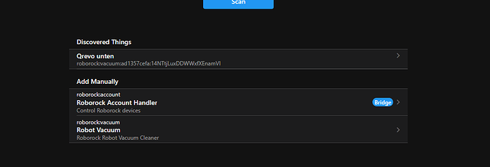

Hey @Paul_Smedley ,
that looks great! Awesome, I found both of may Cleaners (the other one was already added.. :slight_smile: ) :
I will test that in the evening..
Good Job.. :slight_smile:

Finally got it running today. Thx
Several restarts and clean cache made the cleaner show up in the INBOX.
It still was not possible to install the thing by choosing the binding.
