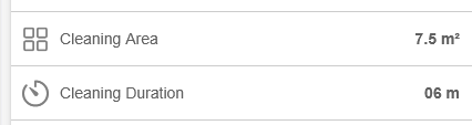

VaccumingRobot_01_CleaningLastCleanArea' changed from 4100000 m² to 7515000 m²
Seems it changed to show how many sqm robot moved through, rather than area of zone that was cleaned. Problem is that value need to be divided by 1000000.
Sorry….. https://smedley.id.au/tmp/org.openhab.binding.roborock-5.1.0-SNAPSHOT.jar should have the divide by 10000. Is that value now what you expect?
Yes, it now aligns more or less with what app is doing - they seem to round up (I’m just using minutes from time right now)
