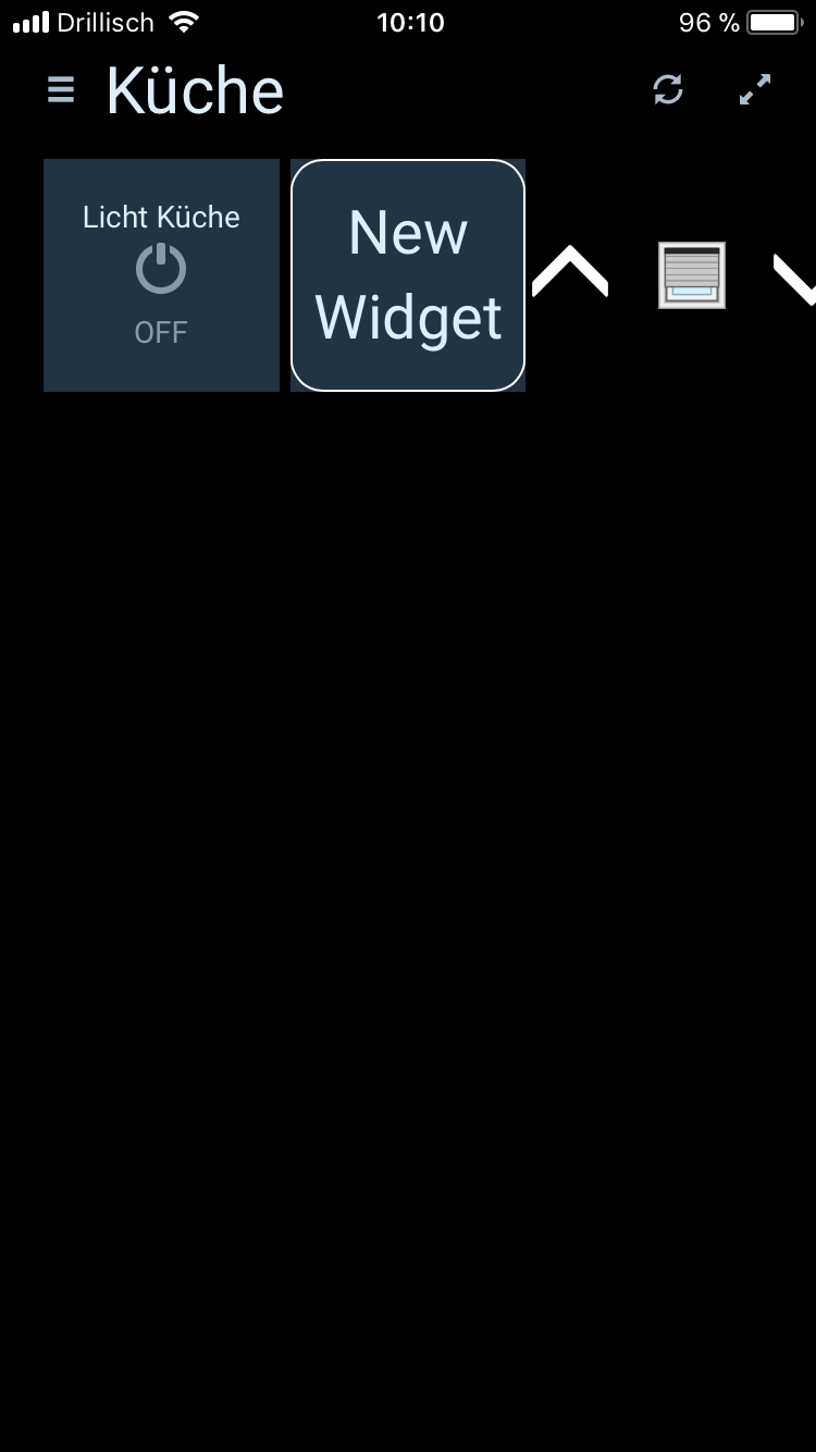

Sorry for the late reply.
Here are the pictures from the iphone and ipad.
both have ios 11.1 installed.
the problem exists in portrait and landscape format.
Yes, it will not shrink below a minimum, which is more than 1x1 tiles. You need to resize the tile horizontally to 5x1. Would that work for you? 4x1 seems like could work too but after some tweaking the code, because it is just on the edge.
