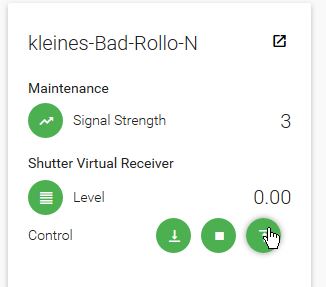

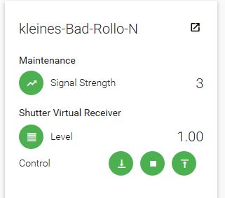

Today I mad a new attempt in PaperUI and I guess it explanes the issue very good.
Values if rollershutter is completly open/up:
If I press the control button for down
it is going down and the value “level” is 100.00
If I am pressing UP Button in control I see a value setting of “0” at level
But the shutter is driving DOWN and after that it shows value 100.00
If I am entering manually value 1 for level it is driving to top/open
Some ideas about that?
Thank you very much
