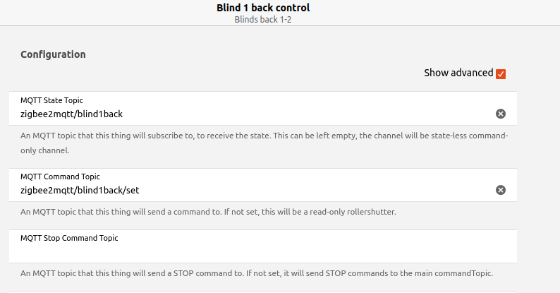

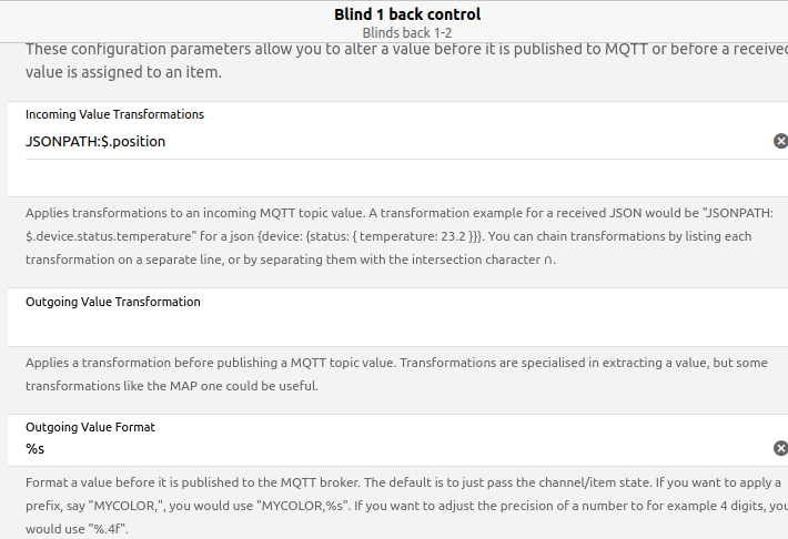

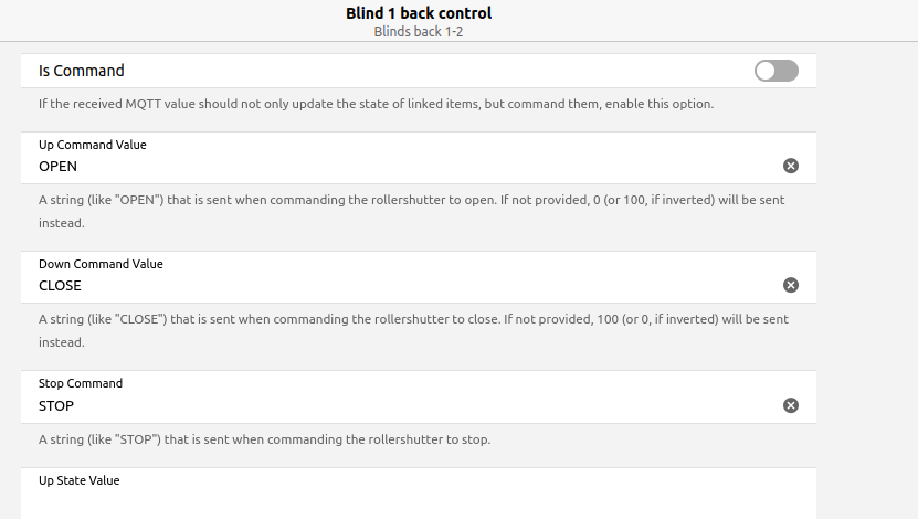

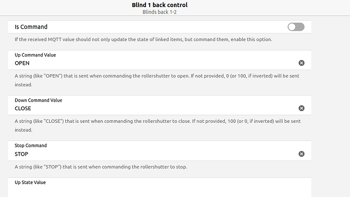

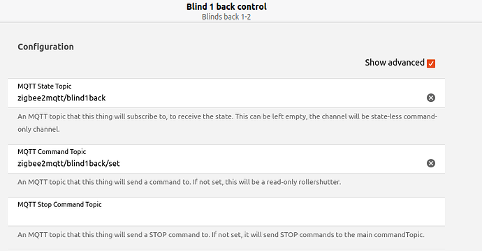

Here is a sample of my roller shutter blind set up:
UID: mqtt:topic:mqttbroker:2910e769b4
label: Blinds back 1-2
thingTypeUID: mqtt:topic
configuration:
  payloadNotAvailable: online
  transformationPattern:
    - JSONPATH:$state
  payloadAvailable: offline
bridgeUID: mqtt:broker:mqttbroker
location: House
channels:
  - id: blind1backcontrol
    channelTypeUID: mqtt:rollershutter
    label: Blind 1 back control
    configuration:
      invert: true
      stop: STOP
      commandTopic: zigbee2mqtt/blind1back/set
      stateTopic: zigbee2mqtt/blind1back
        - JSONPATH:$.position
      off: CLOSE
      on: OPEN
  - id: blind1backposition
    channelTypeUID: mqtt:number
    label: Blind 1 back position
    configuration:
      commandTopic: zigbee2mqtt/blind1back/set/position
      min: 0
      max: 100
  - id: blind1backstatus
    channelTypeUID: mqtt:contact
    label: Blind 1 back status regex
    description: Put regex as STOP command was logging errors
    configuration:
        - REGEX:(^((?!STOP).)*$)∩JSONPATH:$.state
      off: CLOSE
      on: OPEN
Screenshot from 2025-10-06 20-03-48
Screenshot from 2025-10-06 20-03-01
I user a widget to control the blinds.

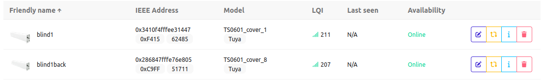

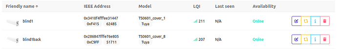

Also if you use the zigbee2mqtt frontend/web you can easliy set friendly names:
frontend:
  enabled: true
  port: 8082
  host: 0.0.0.0
Good luck. Hope some of that helps.
zigbee2mqtt is good once you get used to it. I am using a docker version of it.

- id: rollershuttert
    label: Rollershutter
    description: ""
    configuration:
      commandTopic: zigbee2mqtt/0xa4c1384c85d32598/set
      stop: '{"state":"STOP"}'
      formatBeforePublish: '{\"state\":%s}'
      stateTopic: zigbee2mqtt/0xa4c1384c85d32598
      off: '{"state":"CLOSE"}'
      on: '{"state":"OPEN"}
