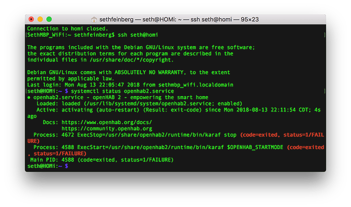

Sorry to bump the thread again, but I’ve been trying to get this to work since I upgraded to openhab2 to no avail. the varlog script and accompanying service work fine but openhab doesn’t even launch if I enable the tmpfs mount for any specific openhab folder. And for the record, I’m ONLY attempting to mount /var/lib/openhab2. One thing to note is that I get a permissions error if I run /usr/local/bin/openhabmount2 without sudo.

So, I’m actually gonna make a new post but I’m concerned my issues run much deeper. I’m not sure when it started but at some point after updating to OH2 my system started crashing sporadically and now its very frequently (it doesn’t make it more than a day or 2 without me seeing the openhab is offline error). Each time is spits out a hd_err_pid file with a new number. Here’s the latest hd_err_pid21273 - Pastebin.com
I thought I licked it by switching to the Zulu install of java, but it appears I was mistaken. I think it would be best to sort this out first.
edit: just realized that the original point of THIS post was to fix frequent crashes and tmpfs was one of the solution offerings, so I will spare the board another post for the time being. If anyone see anything in that error file that will shed some light i’d be most grateful…
