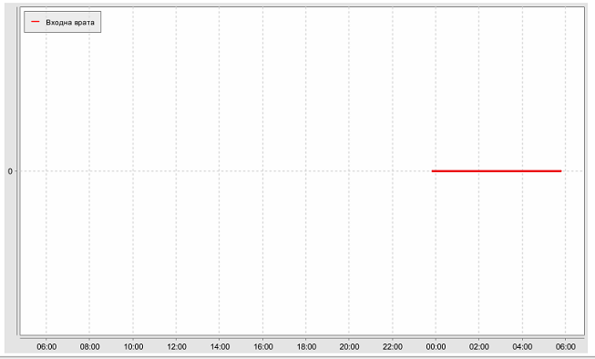

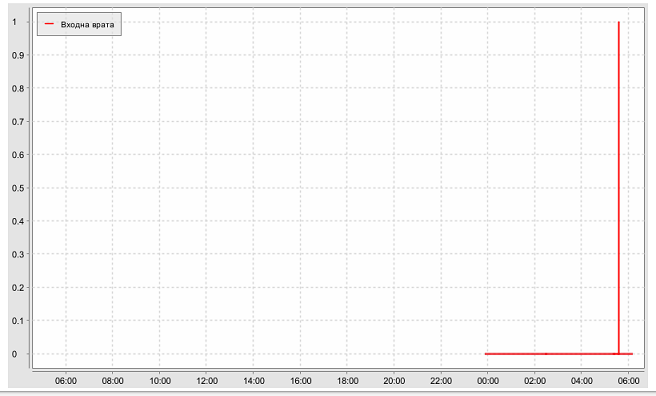

Yes, I know that. I do everetyng right..folder structure and all . Everetyng else work like charm exept contacts and switches, that change status less than minute. My english is very bad… I try explane with pictures:
On Openhab 3.x when open and close door more than a minute I got this
when open and close door for 20 seconds in DEBUG logs everything OK , but in chart
got this
On Openhab 2.5 when open door even for 5 seconds always got

I don’t think that your secondary setup (on windows or what the like) will show this behaviour consistently.
As @Wolfgang_S asked, we would need to know how your rrd4j is really setup (.config and .persist).
As for openHAB 3:
Assuming you are using the default setup of rrd4j (i.e. no custom archives) numeric values are consolidated with the “LAST” function. The value provided by openHAB (by the used strategy like everyChange, everyMinute etc) will be persisted into the DB every 10 seconds. If the used strategy would have provided several values in that timeframe the LAST one would be taken.
Each chart with a timeframe of less then a week will provide data for each 10 second step.
In OH 2 the default setup would be consolidated with the “AVERAGE” function. The value provided by openHAB (by the used strategy like everyChange, everyMinute etc) will be persisted into the DB every 60 seconds. If the used strategy would have provided several values in that timeframe the AVERAGE would be taken.
Each chart with a timeframe of less then 8 houres will provide data for each 60second step. Longer timeframes will be present data that is consolidated further.
