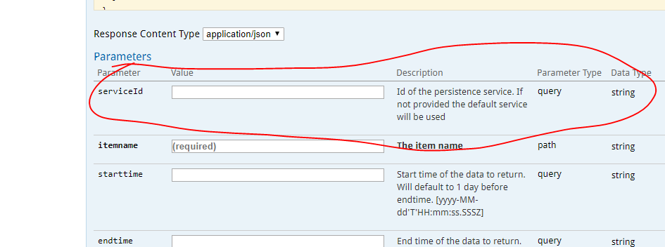

BTW, the reason why i wanted to use the rrd4j database and .perviousState(false,“rrd4j”).state is cause I want to use the previous state of my item in some other rules too whichh execute after this one.
I also had a look in the RestAPI and could not find any datapoints for my item
  "name": "Media_Aktion",
  "datapoints": "1",
  "data": [
      "time": 1572604184212,
      "state": "2"
but there is also no hint if it Shows rrd4j or mapdb.

Did you tell it to search rrd4j? If not it searches the default.
Similarly, as I mentioned above, you are not telling previousState to use “rrd4j” so it’s using your default.
sorry, that was my fault, I forgot the database in RestAPI…bad mistake.
