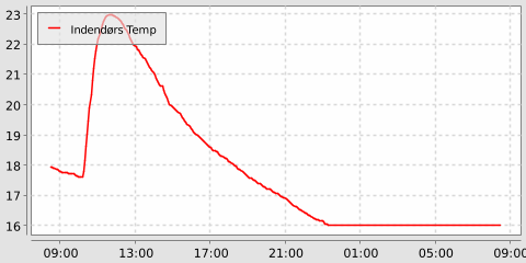

I am not sure if this is the same issue - as you have investigated it a bit more in depth than I - but since upgrading to OH 3.2 through openhabian, from OH 3.1 - I also have issues with RRD4J and charting. After a restart of the system, everything will work normally for 12 hours or so - and then stop charting the items. My charts then look like this:
It seems that RRD4J stops working alltogether.
Restarting the OH service - or the whole server - will reestablish charting and persistance, but no data from the period since charting stopped will have been stored.
I guess it is RRD4J - and MAPDB - persistance which totally stops working - just like @FranzS wrote ?
