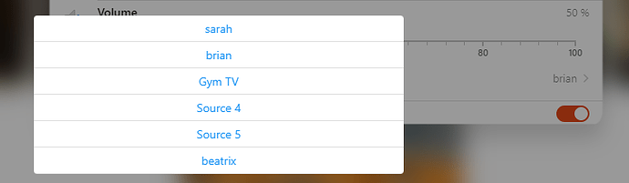

I’m using a wholehome amplifier to drive speakers in 6 locations and on each Location card there is selector to choose a Source.

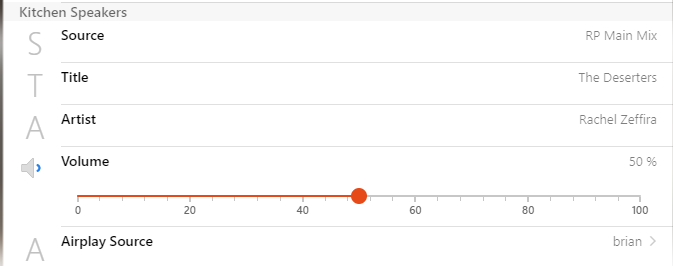

Here is an example of a Location card
What I’d like to do is display the corresponding metadata source when the Airplay source is changed.

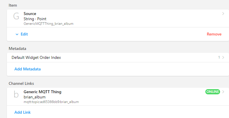

Currently I have the display Items hard-coded to the a MQTT channel, for example

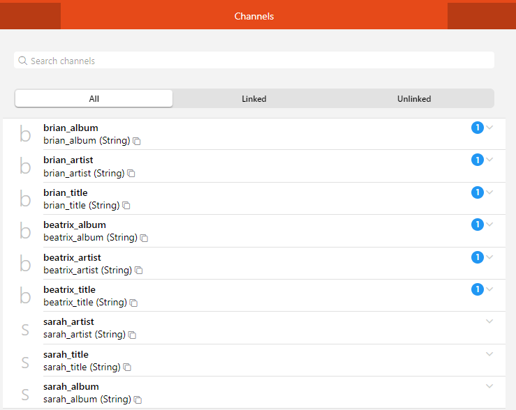

Yes, I have Items connected to channels, but what I’m trying to do is change the channels sent to the Items when I select a new source of audio.
Here are my channels

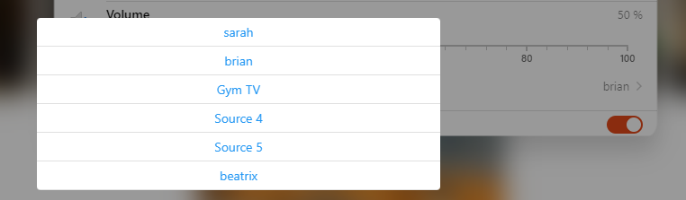

When I select “brian” as a source at a location, I want to display the “brian” metadata and when I change to “sarah” as a source I’d like the Item to display “sarah” metadata.

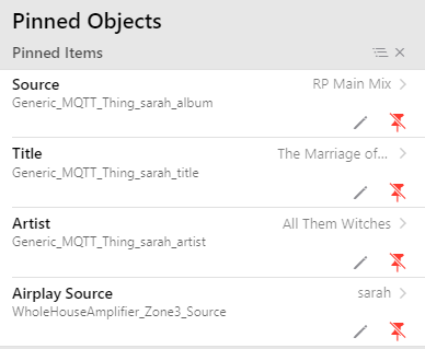

Stated another way I want the Source, Title, and Artist Items to be dependent on the state of the Airplay Source Item.
The question is whether I can modify the display Items with a rule?
