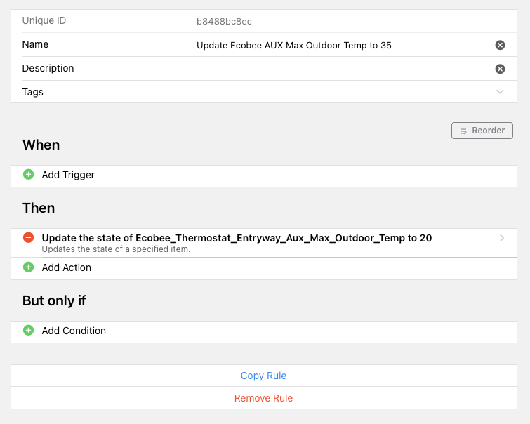

I’m trying to use OpenHab to set the value of ‘Aux Max Outdoor Temp’ on an Ecobee thermostat. The thermostat is currently set to a value of 5 (degrees F) and I want to change it to 20. I have a rule that I think should be effecting this change, and when I run the rule I do see OpenHab change the value, but then a few moments later it reverts back to the prior value.

I am trying to use the GUI to accomplish this, and unfortunately most of the current knowledge available for OpenHab’s ecobee binding references filesystem code/scripts, so I’m checking in here for pointers to what I might be doing wrong.

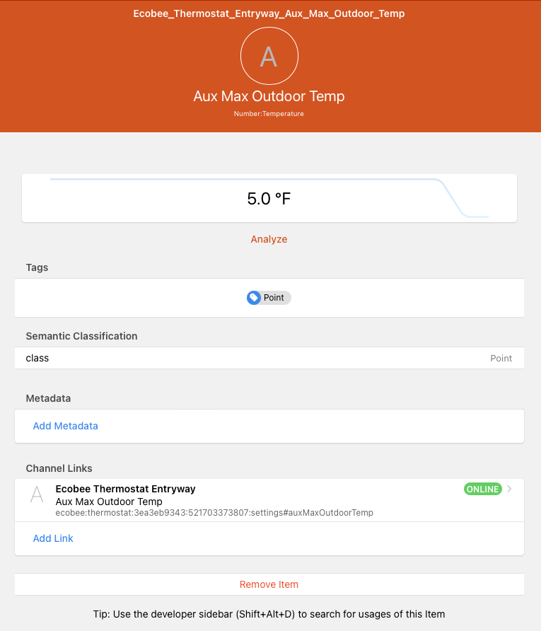

Here’s the item setup:
The rule I’m trying to fire looks like this:
and that rule’s code looks like:

I feel like I’m missing a fundamental concept here, … like maybe I’m setting a parameter value here in OpenHab but maybe I’m not actually sending that to the Ecobee? And when OpenHab checks for the value from the thermostat it just smashes my change?
Or, is there something more strange going on that might explain this unexpected, unwanted, and uncommanded reversion?
