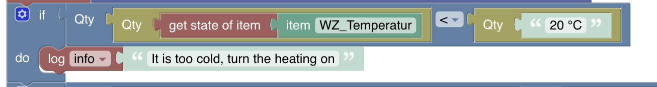

The way to go is the comparison via Quantities. Here is an example:
Hope that helps,
Stefan
Success!
TNX, Stefan!
Tomorrow, I will repair the “hot” rules.
