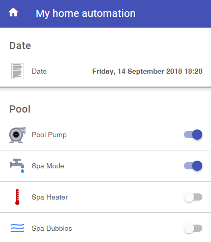

One more question. While fine tuning the rules, I am trying to an issue trying to turn on all switches when the pump is turned off.

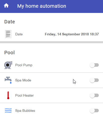

This code works to turn everything else OFF, but when I turn the pump ON again; those switches that were previusly to the pump off, will be shown as ON. If I tried to modify the proxy switch directly within the rule, it will actually show as OFF, but it will be visible on the screen (last screen image).

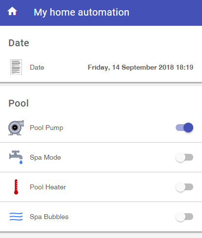

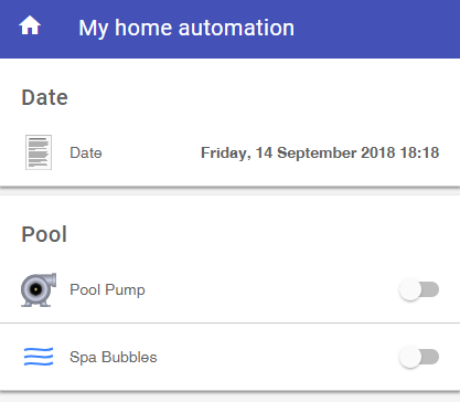

What I am trying to address the use case where switches are OFF out of order i.e. the pump is turn OFF, then I would like all ON switches to be OFF.
I managed to get turn them off but the UI is displaying all switches when the pump is OFF that should be visible only when the pump is ON.
i.e.
Pump OFF → Spa Mode (not visible)
Pump ON → Spa Mode (visible)
Pump ON → Spa Mode ON
Pump ON → Spa Mode OFF
All good and it works. Here is the issue
Pump OFF → Spa Mode (switch does turn OFF but still visible. Since the pump is OFF this switch shouldn’t be visible)
Hope it is more clear now.
