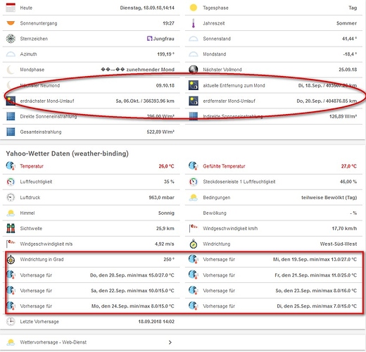

Hi all,
I have a little problem with two Rules which should concatinate two items into one.
The error messages are:
2018-08-30 00:42:24.880 [ERROR] [ntime.internal.engine.RuleEngineImpl] - Rule 'moondistances': The name 'Date_Kilometer_actual' cannot be resolved to an item or type; line 134, column 5, length 21
2018-09-01 00:15:49.409 [ERROR] [ntime.internal.engine.RuleEngineImpl] - Rule 'moondistances': The name 'Date_Kilometer_actual' cannot be resolved to an item or type; line 173, column 5, length 21
2018-09-02 16:14:42.491 [ERROR] [ntime.internal.engine.RuleEngineImpl] - Rule 'moondistances': The name 'Date_Kilometer_actual' cannot be resolved to an item or type; line 173, column 5, length 21
2018-09-03 15:34:45.361 [ERROR] [ntime.internal.engine.RuleEngineImpl] - Rule 'moondistances': The name 'Date_Kilometer_actual' cannot be resolved to an item or type; line 173, column 5, length 21
2018-09-04 14:20:07.229 [ERROR] [ntime.internal.engine.RuleEngineImpl] - Rule 'weather forecast formatting': The name 'Date_MinMax7' cannot be resolved to an item or type; line 12, column 25, length 12
2018-09-05 13:24:45.900 [ERROR] [ntime.internal.engine.RuleEngineImpl] - Rule 'moondistances': The name 'Date_distance' cannot be resolved to an item or type; line 173, column 38, length 13
2018-09-05 18:16:37.448 [ERROR] [ntime.internal.engine.RuleEngineImpl] - Rule 'weather forecast formatting': The name 'Temp_MinMax4' cannot be resolved to an item or type; line 9, column 96, length 12
2018-09-08 23:39:34.286 [ERROR] [ntime.internal.engine.RuleEngineImpl] - Rule 'moondistances': The name 'Kilometer_distance' cannot be resolved to an item or type; line 165, column 99, length 18
2018-09-09 00:49:37.691 [ERROR] [ntime.internal.engine.RuleEngineImpl] - Rule 'moondistances': The name 'Date_Kilometer_perigee' cannot be resolved to an item or type; line 166, column 5, length 22
2018-09-09 12:10:21.148 [ERROR] [ntime.internal.engine.RuleEngineImpl] - Rule 'moondistances': The name 'Kilometer_distance' cannot be resolved to an item or type; line 165, column 99, length 18
2018-09-10 02:58:42.402 [ERROR] [ntime.internal.engine.RuleEngineImpl] - Rule 'weather forecast formatting': The name 'Forecast_1' cannot be resolved to an item or type; line 6, column 3, length 10
2018-09-16 11:43:57.029 [ERROR] [ntime.internal.engine.RuleEngineImpl] - Rule 'weather forecast formatting': The name 'Forecast_7' cannot be resolved to an item or type; line 12, column 3, length 10
2018-09-16 23:06:45.104 [ERROR] [ntime.internal.engine.RuleEngineImpl] - Rule 'weather forecast formatting': The name 'Date_MinMax2' cannot be resolved to an item or type; line 7, column 25, length 12
2018-09-18 13:02:45.647 [ERROR] [ntime.internal.engine.RuleEngineImpl] - Rule 'moondistances': The name 'Date_distance' cannot be resolved to an item or type; line 134, column 38, length 13

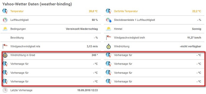

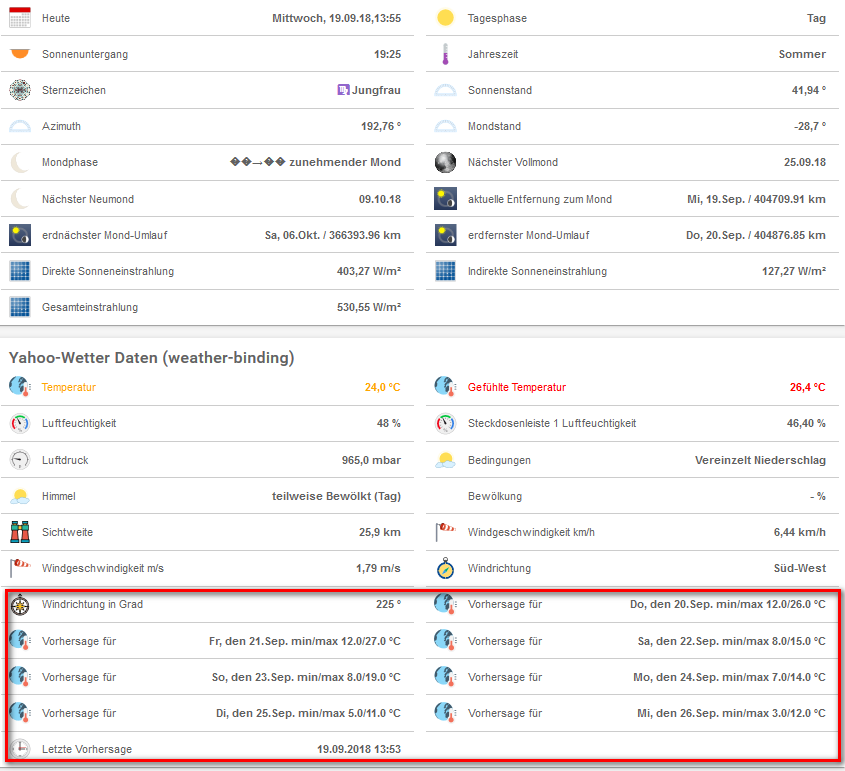

But the result seems to be correct when the rules are fired a second time as one can see in the snapshot below
As one can see in the error messages, it’s not always the same item which is reported.
Is it my Rule-Syntax ?
Has anyone an idea ?
Regards
Peter

and inserted the Group “gWeather” as defined in my .items file. But after the restart (as above) I had the same error again, as you can see in the below log.file(and snapshot). This time with item ‘Date_MinMax6’ which is part of the gWeather-Group.
2018-09-19 12:52:09.501 [INFO ] [er.internal.HomeBuilderDashboardTile] - Started Home Builder at /homebuilder

2018-09-19 12:53:11.246 [ERROR] [ntime.internal.engine.RuleEngineImpl] - Rule 'weather forecast formatting': The name 'Date_MinMax6' cannot be resolved to an item or type; line 11, column 25, length 12
2018-09-19 12:53:18.691 [INFO ] [smarthome.model.script.startup-rules] - Raspberry-Status ist : CPU_RasPi_Temp_num (Type=NumberItem, State=0, Label=CPU-Ras-Pi Temperatur, Category=temperature, Groups=[Chart_Sys_Temp])
2018-09-19 13:16:02.538 [INFO ] [marthome.model.script.astro-rules_06] - Mittag - noon. START
And half an hour later, when the Rule is triggered again from the Binding, everything’s ok again and no more errors. So I’m wondering if somethings wrong with my mapDB.
Next step I will test now a createTimer in the Rule, althoug this means a delay every time when the rule is triggered. I will give you a reply, when I have tested it, even if it’s good or bad. And I will set back my smarthome.event.log from WARN to INFO to find more Infos.

In the meantime I have installed the Rule-Version with createTimer -Functionality and it works now without an error. So this workaround will solve my problem 'til the developers find the best way.
