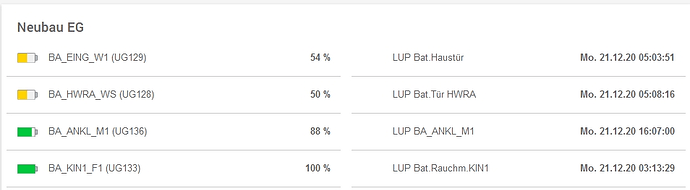

I have chosen a different approach. I put the battery items in a group called ZWOGUP and create an additional item for each battery item for the last update timestamp. This DateTime item hast the same name as the battery item but ends with the suffix _LUP (for LastUPdate):
Number 	 BA_KOCH_WS  "BA_KOCH_WS (OG186) [%d %%]"  <battery> (zwogup) {channel="remoteopenhab:server:ZWOG:node186_battery_level"}
DateTime BA_KOCH_WS_LCH	"LCH Bat.Terr.tür Süd [%1$ta %1$td.%1$tm.%1$ty %1$tT]"	<clock>
DateTime BA_KOCH_WS_LUP	"LUP Bat.Terr.tür Süd [%1$ta %1$td.%1$tm.%1$ty %1$tT]"	<clock>
Then I have a rule that is triggered when a member item of the group ZWOGUP receives an update. In the rule I post the actual timestamp to the _LUP-item:
rule "MemberUpdatezwogup"
    Member of zwogup received update
    postUpdate(triggeringItem.name+"_LUP", new DateTimeType().toString)
So I have a timestamp for all my battery items and I slo grouped them on one page in my BasicUI sitemap:

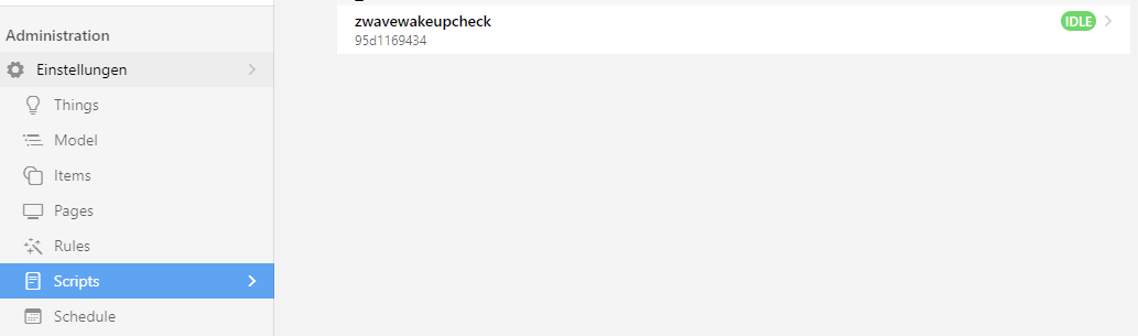

I added the automation and tried to first put a thisrule.py in OH-Conf/automation/js223
there it already was not recognized. I further tested the helloworld example from the docs. Aswell that script does not show up in the log.
So next try: via UI … added the code from above … there I have a run now option but it seems like the when definiton from the script is being ignored?
should when adding the script via UI only the script part being added and the schedule being set via “schedule” from the menu or is this either or…? confused
