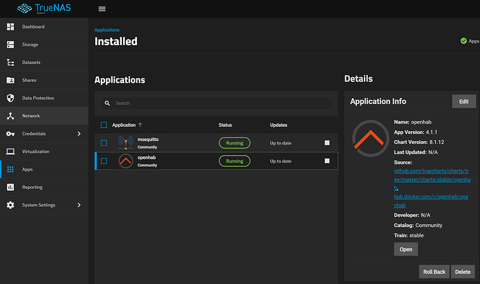

Also what’s your openhab version?
If you’re still using openhab 3.x, you need to set some configurations, especially step 2 in
the Installation steps
If you’re using openhab 4.x you don’t need to do this step 2.

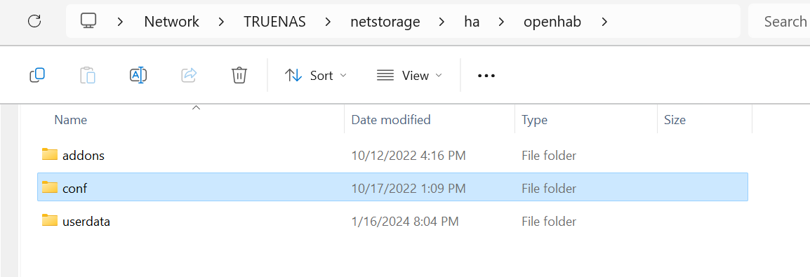

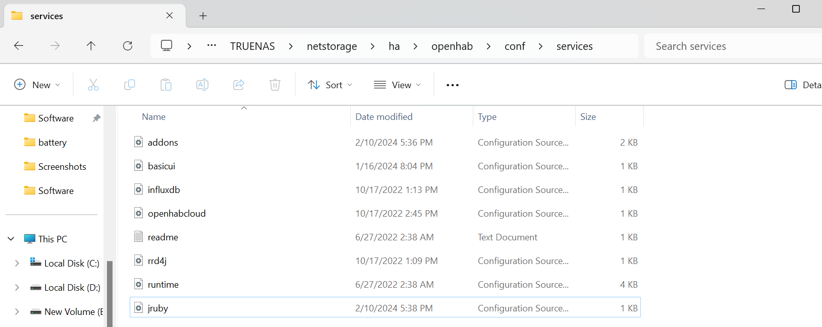

Doesn’t the newly created file have to be put in the rules folder?

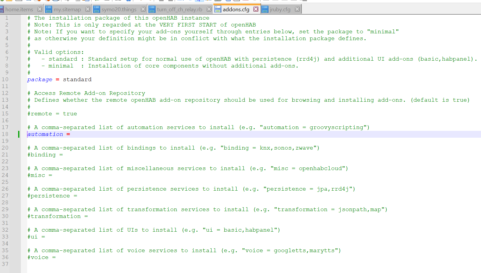

in my addons.cfg i need just to uncomment automation= ???
they need to be `automation=jrubyscripting’ ?

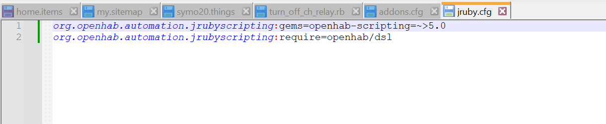

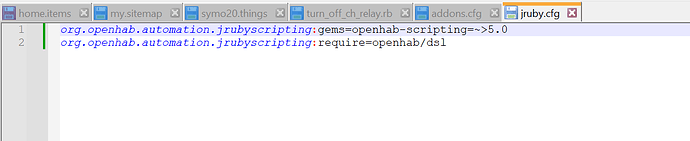

my jruby.cfg

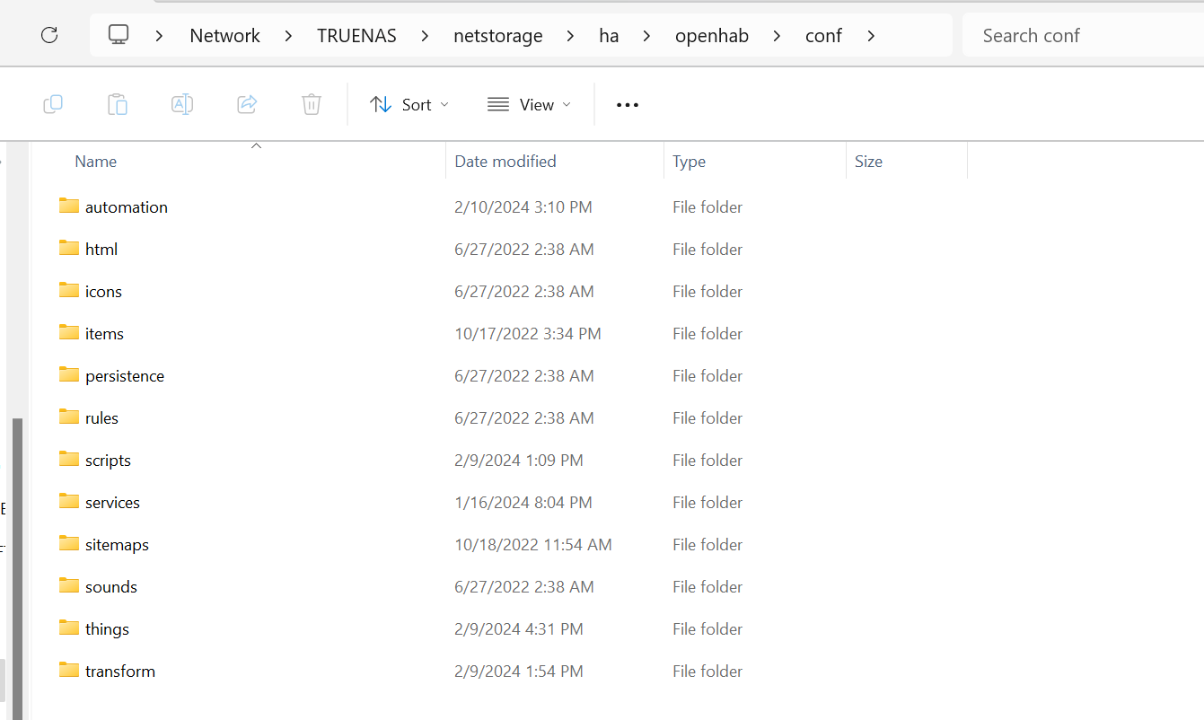

No. The conf/rules/ folder is strictly for RulesDSL scripting language. It is not for Ruby rules.
Ruby rules should be saved inside the conf/automation/ruby/ folder with a .rb extension.
No, if you did that, you’ll be telling openhab to install NO automation addons.
it needs to be:
automation = jrubyscripting
Then give it 1-2 minutes to install. You can confirm that it’s installed by looking in the MainUI Add-ons Store → Automation.
I thought you had already installed jrubyscripting based on your screenshot a few posts earlier!
Your jruby.cfg looks fine.

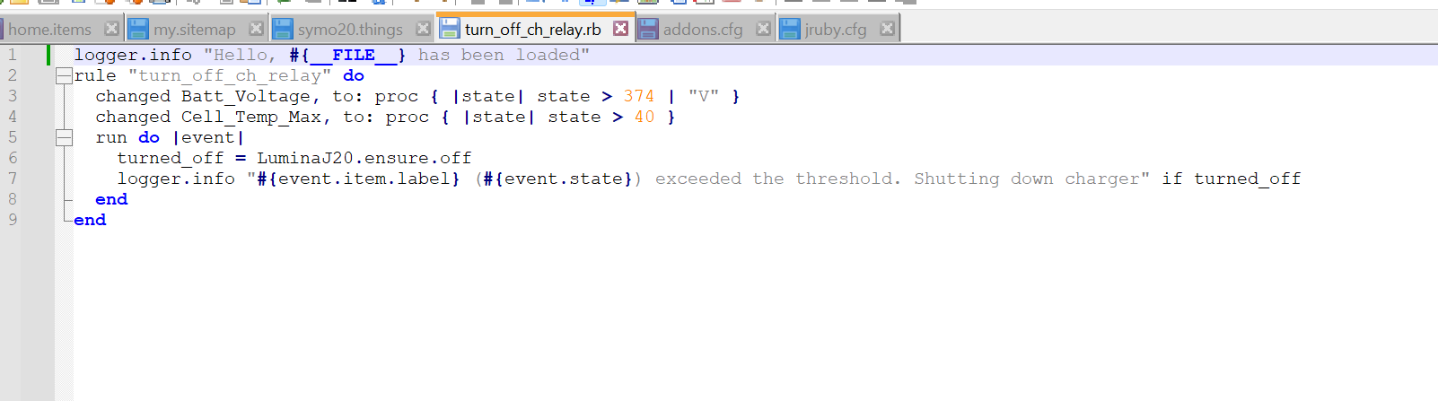

Next we need to figure out why the file isn’t loaded or isn’t executed.
Do you know how to get to Karaf console to view openhab’s log, or to view the userdata/logs/openhab.log file?
If so, inside your turn_off_ch_relay.rb file, add this line at the very top of the file (line 1)
logger.info "Hello, #{__FILE__} has been loaded"
then save the file. You should see an entry in openhab’s log like this:
02:00:44.633 [INFO ] [enhab.automation.jrubyscripting.test2] - Hello /openhab/conf/automation/ruby/turn_off_ch_relay.rb is loaded
The file is not loaded - i do not see this in logs.

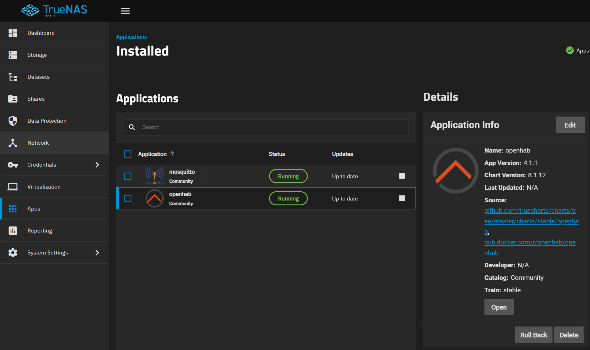

I have OpenHab installed on Proxmox, I will test your instructions there as well.
It could be that something is not good here on Truenas

That seems like a permission issue. The openhab user couldn’t create directories under conf/automation. Perhaps wrong directory ownership somewhere? Did you manually create some folders? If you did, perhaps you did that as root, so those folders are owned by root?
Fix the permissions and restart openhab.
