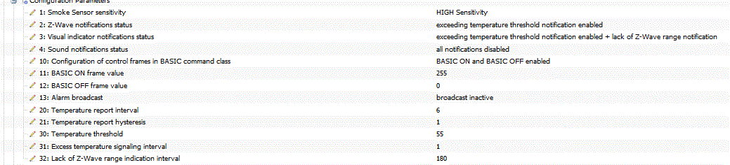

So I think I have an error in configuration of the items. Could you please post your configuration? I tried a lot and nothing helpled. Now I am a bit confused. :wink:
@mstormi, thanks for the screenshot, but could you please also post Association Groups screen and items configuration strings related to the FGSD-002 device.
Controller is in all 5 association groups

@mstormi, so as you can see my config is the same as yours. I’ve also added my sensor to all 5 association groups. But I NEVER get:
  1. 255 for Smoke SENSOR_ALARM, I always get 0. So, how can I distinguish between ā€œcalmā€ and ā€œalarmā€ states, as in both of them the sensor reports ā€œ0ā€? It doesn’t matter for me whether 0 (CLOSED) means ā€œcalmā€ and 255 (OPEN) means ā€œalarmā€, or vice versa, 0 means ā€œalarmā€ and 255 means ā€œcalmā€. But these two states SHOULD BE DIFFERENT, that’s the main problem.
  2. Heat SENSOR_ALARM at all, even when the temperature rises above the configured threshold.

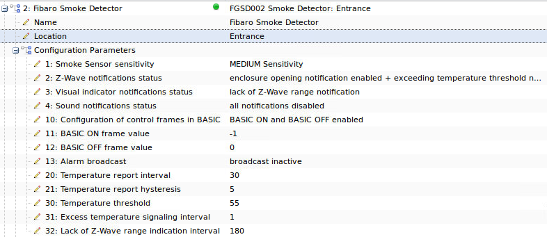

I also have problems with configuring the FGSD002 Fibaro Smoke Sensor. When i trigger the sensor with actual smoke (@roher: You only need enough), I get the following response:

I’m also trying to make FGSD-002 works with OpenHAB, and I get the same issue: only ALARM=0 when manually raising an alarm.
I’m using a ZWave Plus controller (Aeon Labs).
Is someone able to make it work?
Thanks for your help.
After many tries, I was able to receive alarms by adding ā€œrespond_to_basic=trueā€. And by adding controller in Group 2 & 4.
According to Victor’s previous message, it is not the ā€œZWave plusā€ way to do, but openhab seems to lack some compatibilities here…

I’d like to share my experience with this sensor that I’m using with a z.wave.me usb stick, so with zwave plus support.
This is my configuration:
Sincerely before to get the green light I had to wake up the sensor several times.
I couldn’t figure out why the Basic ON frame value is -1, even if I change it to the default value (255) it goes back to -1.
Anyway I was able to get values from all the following items:
Contact ZWaveFibaroSmokeDect "Corridor Smoke Dect [%s]" (ZWave, SmokeDetector) {zwave="2:command=sensor_alarm,alarm_type=1" }
Contact ZWaveFibaroSmokeDect_Heat  "Corridor Heat Dect [%s]" (ZWave, SmokeDetector) {zwave="2:command=sensor_alarm,alarm_type=4" }
Contact ZWaveFibaroSmokeDect_Tamper  "Corridor Smoke Dect Tamper [MAP(en.map):%s]" (ZWave) {zwave="2:command=sensor_alarm,alarm_type=0" }
Number  ZWaveFibaroSmokeDect_Battery  "Corridor Smoke Dect Battery level [%d %%]" (ZWave) {zwave="2:command=battery" }
Number  ZWaveFibaroSmokeDect_Temp  "Corridor Smoke Dect Temp [%d°C]" (ZWave) {zwave="2:command=sensor_multilevel,sensor_type=1" }
And as others here I got CLOSED status for the three alarm type items.
