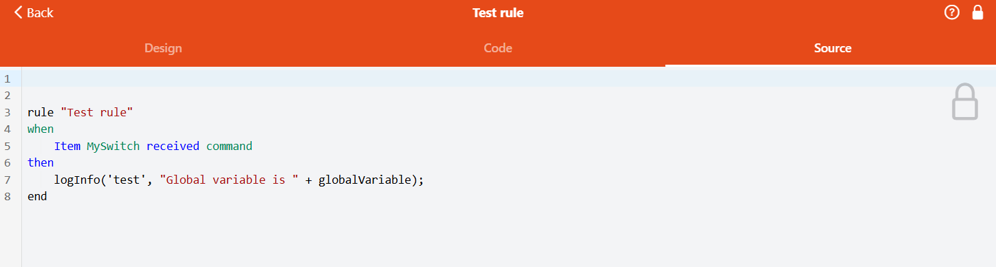

I’ve managed to retrieve and include the “source” for DSL rules, but there’s a problem - the shared context is missing. There is just an empty line where the global variable should have been defined:

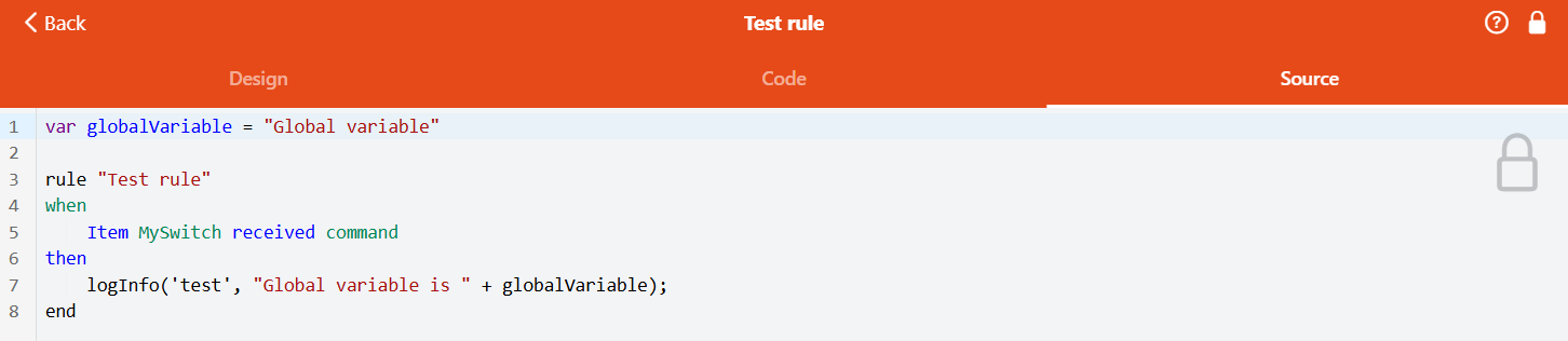

I was lucky. I took a chance and called .getParent() on the “rule node”, and then it includes everything:
However, I still need to figure out a way to determine if there is any shared context or not.

This now correctly detects shared context for all my tests:
