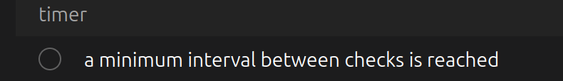

Can someone explains what means and what is the purpose of this condition ?
What means “checks” in that context ?
I don’t know it, but it seems like, if you have a trigger that might happen very often, depending on other circumstances, but you want to make sure that the rule doesn’t run too often, you can set a condition that it won’t run more than e.g. once a minute.
I interpret it as “triggering”, but perhaps it’s badly worded.
It is badly worded, but it is not “minimum interval between triggers”.
A better description may be: “a minimum interval since the previous rule execution”.
Say you have triggers that can occur as often as every second, but you only want to run your rule every 60 seconds at most, and not any more often than that. In this case you would set the minimum interval to 60 seconds and it will ignore triggers until 60 seconds have passed since the last rule run.
It is what I meant, you can’t prevent the triggers, but you can prevent letting them trigger. That is, reject any triggers that occur before the defined interval has elapsed since the rule was last triggered.
Yes I understand what you meant and I knew you were going to come back with this statement! :slight_smile:
Using the word “trigger” or “triggering” or “trigger*” may cause ambiguity / confusion, so it’s best to avoid it.
