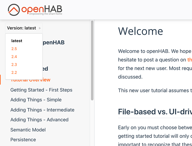

Well, if you just go to the URL I posted (Runtime Commands | openHAB), you will find the selector points to “latest”, but the contents, well, not so much

Now if you change the version from latest to 2.5 by clicking where it says “Version: latest” and choosing 2.5 from the list, you will see the docs for OH 2.5.
Notice the URL has v2.5 in it and it says “Version: 2.5” in the upper right. Most importantly notice that the command are correct for 2.5, namely they start with “smarthome” instead of “openhab”. That is the correct docs for OH 2.5.
As far as I can tell, assuming that the docs are working properly and not resetting as they did for J-N-K, the main confusion was in either assuming that this didn’t change between OH 2.5 and OH 3 or not realizing that the latest version of OH is OH 3 and you need to look at a previous version of the docs for OH 2.5.
tl;dr: The page pointed to by latest even in your URL are the correct docs for the latest version of OH. OH 2.5 is no longer the latest and these are among the breaking changes between the two versions.
you can perfectly (safely?) assume that 2.5 is latest. It is a common pattern in sites with versioning to list every single release and have “latest” pointing to the actual latest release number listed. Why? Because you can’t tell there is a 3.0 version released from that list. I mean, you and many others in the community are aware for sure, but not non-regular users like me. If you ask me, from that list, 2.5 is latest…
