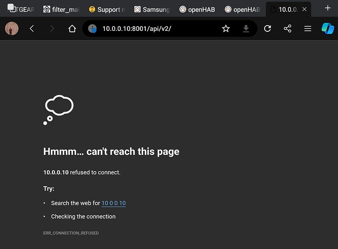

Also, what is the output of http://ip:8001/api/v2/
Thanks for reply. My thing setting is created from ui
Above is the thing config. Will get the trace and share here
This is the output of url
@tizen
In your web page screenshot it shows the ip address as 10.0.0.10, but your thing shows the ip address as 10.0.0.15.
Did you get the ip address wrong?
I also do see that you have a websocket token saved. I will be interested to see what the TRACE report says, as to why the token is not being accepted.
Do the trace after a restart, when it asks you to authenticate again, otherwise it will just show the token being accepted.
And make sure you don’t have your TV set to require authentication “Always”. Should be “first time only”.
