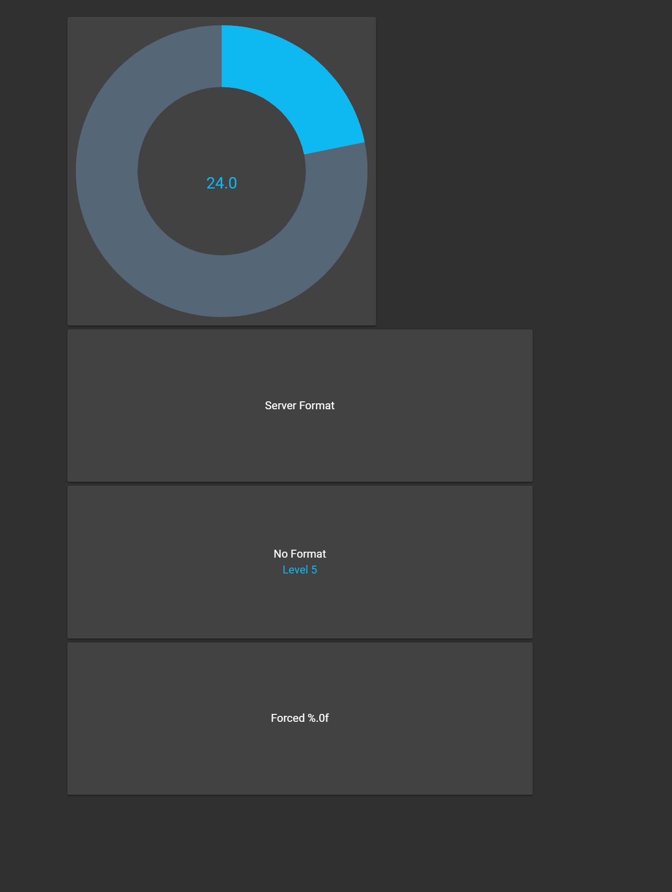

What I see:
I would have expected:
- the Server Format one to work (show the scaled value)
- No Format should show the raw value (or not, either seem correct)
- Forced should show the value
Looking into the debug log for Chrome it is full of errors saying numeric expected, string provided which makes sense as to why the last one is not showing.

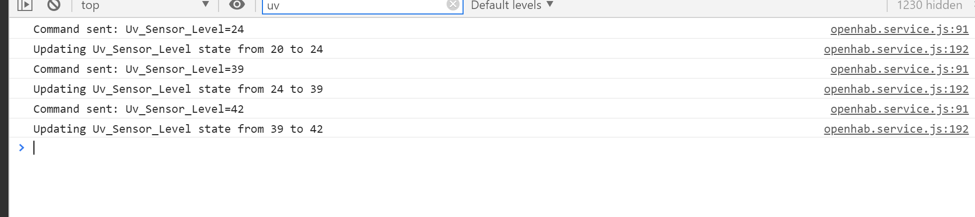

I see in chrome console I get this
The raw number is coming to the browser.
Is this expected? It seems wrong to me
