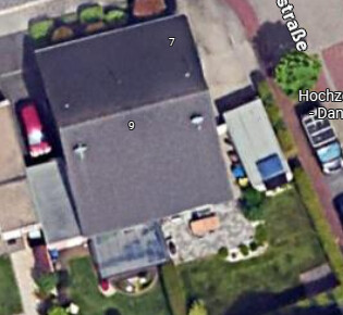

The script generates an SVG file in the openhab/html directory by default, making it easy to integrate into your OpenHAB UI. Every time the sun’s azimuth changes, the script regenerates the SVG, ensuring your panel always displays the correct sun position, shadow, moon, and wind direction.
Example (Dark Basic UI):
blue line → wind direction
yellow dot → sun :slight_smile:
gray half dot → moon phase & position
green half circle → daytime (half is noon) half on the other end is midnight
everything is rotating and changing in relation to your house.
The raw SVG is transparent
You can easily customize the colors in the file to match your preferred style.
How to Use It?
Simply adjust your location details, define your house shape, and tweak colors if needed. Other than that, the script runs independently and doesn’t require anything beyond a wind angle.

One thing, I’m not very good in calculating the coordinates, is there a tool out there, where I can draw lines and they’ll get translated in the correct shapes already?
I created mine using GIMP, which allows you to convert a drawn image into an SVG shape. From there, you just copy the coordinates and adjust them to match the format used in the Python script.
That was the easiest method I could find.
The only tricky part was rotating the house correctly to match the WNES (West, North, East, South) orientation. It needs to be precise; otherwise, the sun’s position relative to the house will be completely off.
Google Maps was a great help for this—I took a screenshot of my house, added a new layer on top, and traced it to align everything properly. Some minor tweaking was needed to determine where to place the first coordinate in the SVG format, but once that was sorted, the rest was straightforward.
I have done this as follows:
  1. Copy your home from Google Maps
  2. Scale the image to 100 x 100 px with XnView
  3. Check the coordinates with
    Mobilefish.com - Record XY mouse coordinates on an uploaded image
  4. Move the image of your house by adding an offset to all x and y coordinates (in shadow.py) so that your house is in the center of shadow.svg. You just have to try it
Thank you for the online link. Can you please post your SHAPE-hashmap?
Perhaps I’m just too stupid, but my coordinates are quite simple and look something like:
so, my SHAPE looks like this:
SHAPE = [
    {'x': 21.00, 'y': 87.00}, {'x': 92.00, 'y': 75.00}, {'x': 81.00, 'y': 9.00}, {'x': 11.00, 'y': 19.00}
but the SVG looks not really good :wink: :
From what I think, the light_color shouldn’t be on the north-west part of the house…?
Here are my coordinates, but beware they are not exactly the same as in the example, I just did that today.

yes, you have inverted it - this was my initial issue as well,
that’s where gimp was handy - mirror it by the X and Y as it is now showing shadow otherway round than it should be
