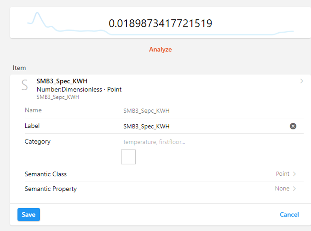

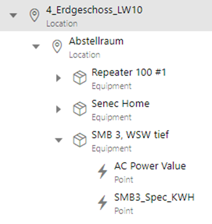

I composed a Blockely thing where I compute stuff and write the result into an Item that I have freshly created as part of an existing thing or/and as part of a location. That seems to work and I guess that is ok?

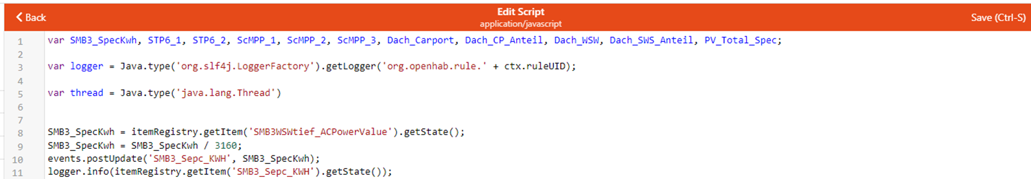

When I do that, I notice that I can not grab my Blockely script from “scripting” from the interface as it is not shown. As a workaround, I copy the code generated by Blockely and paste that into the rule-script window. Is that how it should be?

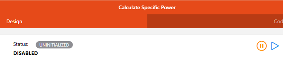

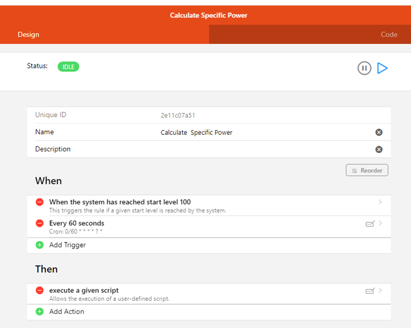

I then start my rule but am a bit surprised that is says “idle” even though it does its thing every 60 sec or so. How do I pause that script? Simply by pushing the pause button where it then says “uninitialised? I then havet o “unpause” it and then hit run to start it again. Is that OK?
If I then paste an update of the script and start it again, is then a new rule process started or is the old rule re-started? I am asking as I am a bit afraid that I might have a lot of rules running in the background that were never quite stopped and eventually flood the system.

It probably takes only a dozen milliseconds or so for the rule to run. It likely goes from running to idle faster than the UI can update the badges to show it was running. You can see the rules changing state between running and idle by watching the event stream in the developer sidebar (alt-shit-d) or by setting the logging to enable those to be logged to events.log.
Only long running rules (those that take half a second or more) would show in MainUI.
It’s OK but I think you have a miss understanding on how rules work. They are only running when actively processing an event. The rest of the time they are either idle (i.e. waiting to be triggered) or UNINITIALIZED (i.e. disabled). Click the pause icon and that disables the rule. Clicking the play button triggers the rule.
You don’t have to click play to cause the rule to start handling events. If it’s enabled (i.e. idle) it is already going to process the events that the rule defines. The play button is a way to manually cause the rule to trigger.

Impossible. A rule is only running when it’s been triggered. Only one instance of a given rule can run at a given time. You can have no more rules running in your system than you have rules defined.

If you want to run something periodically, that’s what the Time rule triggers are for. Just create a rule, trigger it with a time cron trigger, and it will execute based on how you’ve configured the trigger.
It’s all 100% event driven. A rule triggers based on an event.
