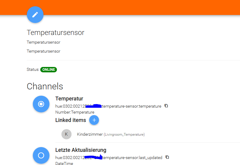

NO, I meant, is the Thing online in the PaperUI? Can you give me a screen shot of the one that work and of the one that doesn’t
The bottom one work “temperature-sensor”
The above one don’t work “temperature-sensor1”
The working one:
The not working one:
The two things have the same name…
