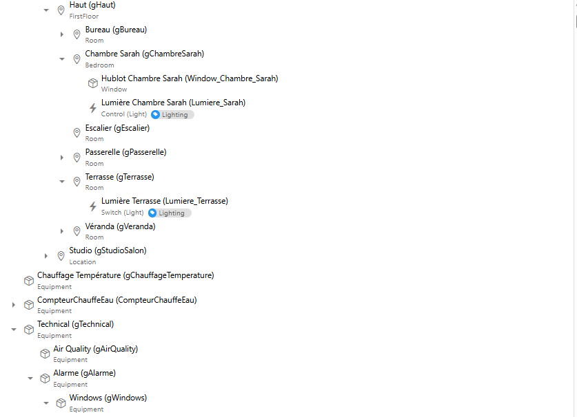

So what I would like is the contact be a member of a Window group, itself member of a Alarme group. But to display them in the semantic model, I would need to tag this group as “Equipment” ?
And do it will break the rule we talked before ?
Is this right ? How to code such scheme ?
Perhaps would we need an EquipmentCategory above the Equipment tag when we want to do such grouping ?

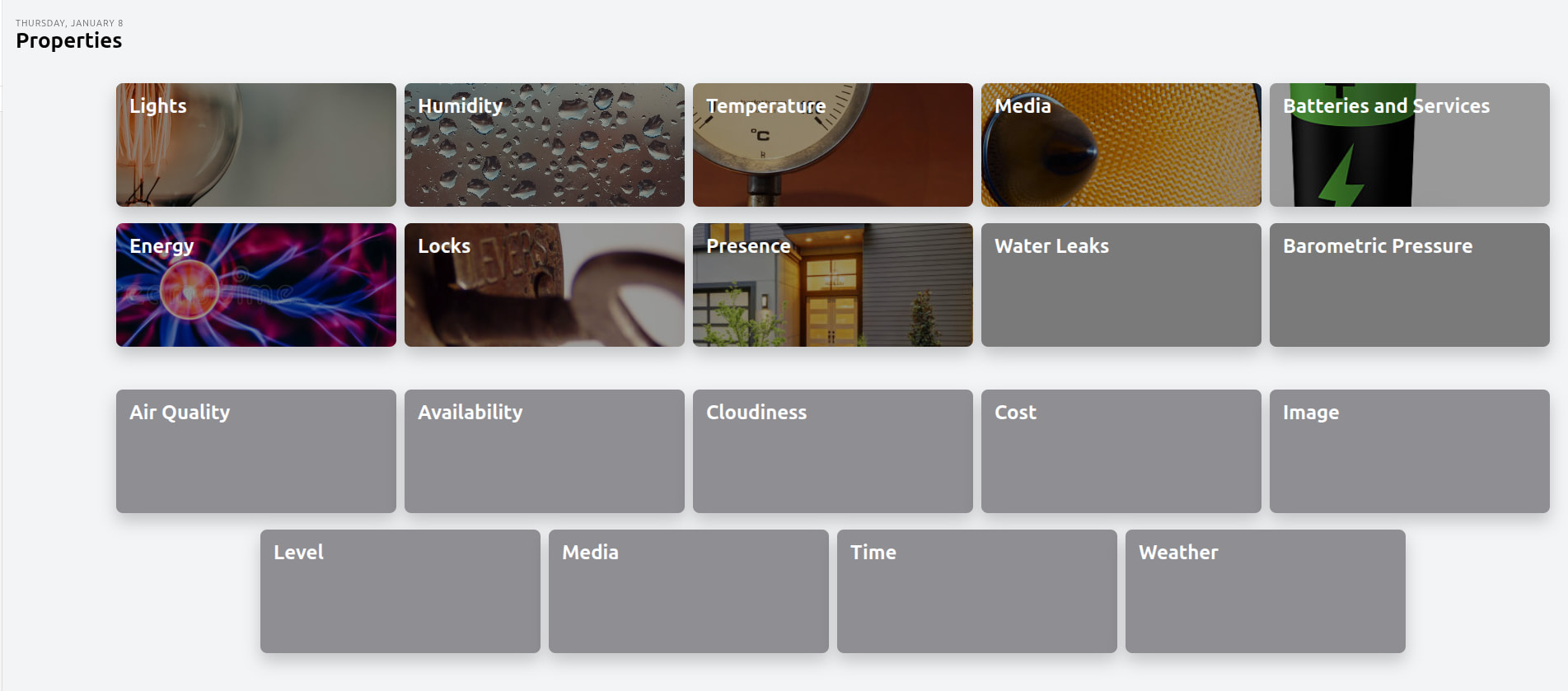

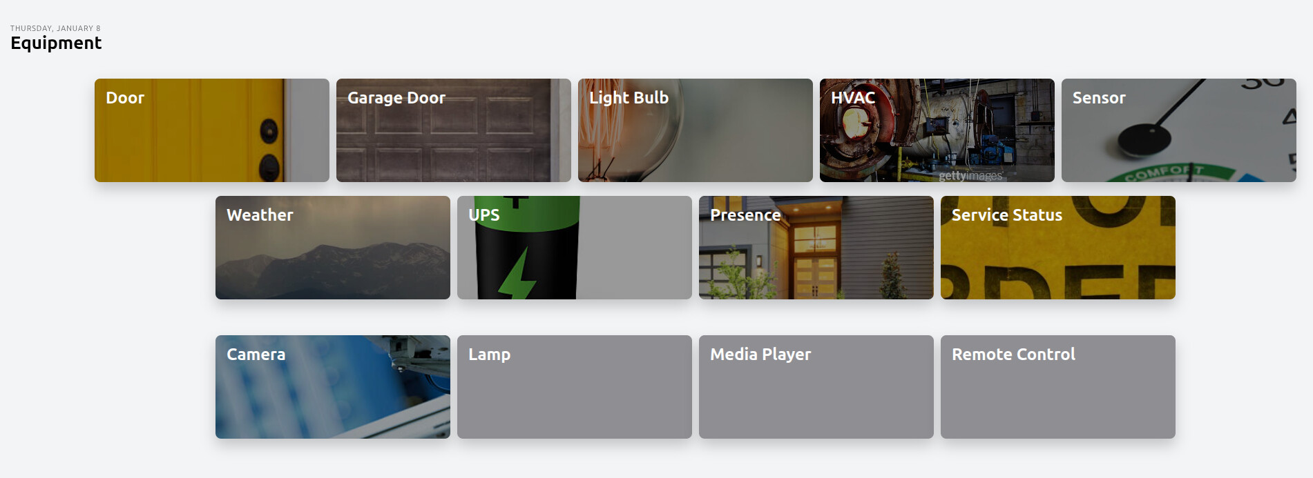

You can’t have this in the model.

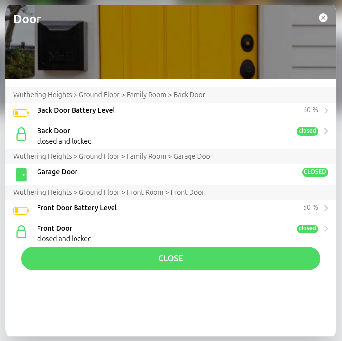

That’s what the Equipment and Properties tabs of the Overview page are for. You already can see everything grouped by Equipment type (I’ve not updated the background images in these cards yet so some of them are grayed out).

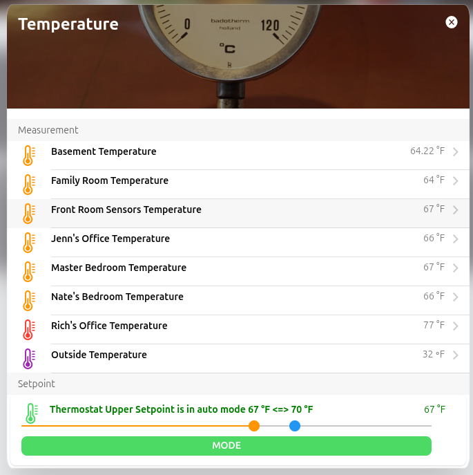

And you can see them grouped by the property they measure or control.
The semantic model is primarily about your end users, not you as the administrator. The semantic model controls how the cards in MainUI’s Overview tab are organized. It’s not there to make a tree in the Model view to help you administer your home automation.

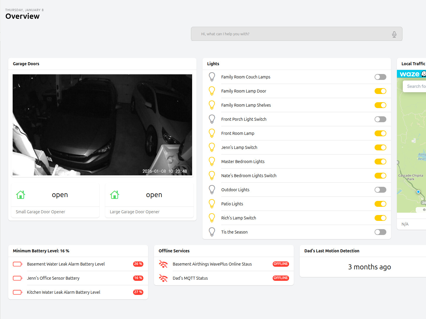

And, if you have a need to group things together for you home automation, you can use the oh-repeater to create a widget to show on the first page of the overview page for your users that use the semantic tags to identify the Items to show.
In the screenshot above, the lights, battery, and services widgets are built based on the tagging on the Items and the states of the Items.
