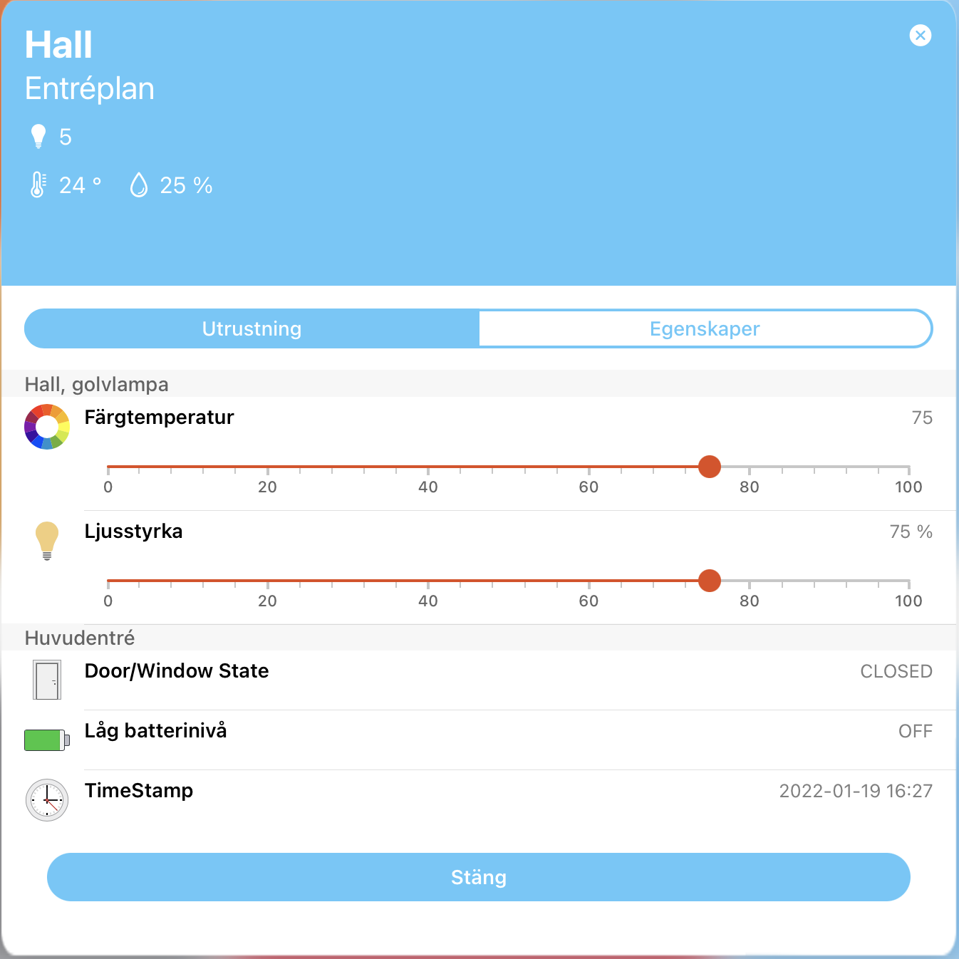

Just upgraded to 3.2 and have a few questions regarding the semantic model. I have door sensors connected to my alarm and there are three channels that I am planning to present to the user in various places: status (open/closed), timestamp (last time the door was opened/closed) and low battery (switch).
In the semantic model, I have an equipment “door” (item: group), connected to a room in my building as direct parent group. The door equipment contains three points:
“Door state”, item type: Contact, semantic class: Status, property: Opening
“Door time stamp”, item type: DateTime, semantic class: Point, property: None
“Door low battery”, item type: Switch, semantic class: LowBattery, property: Energy

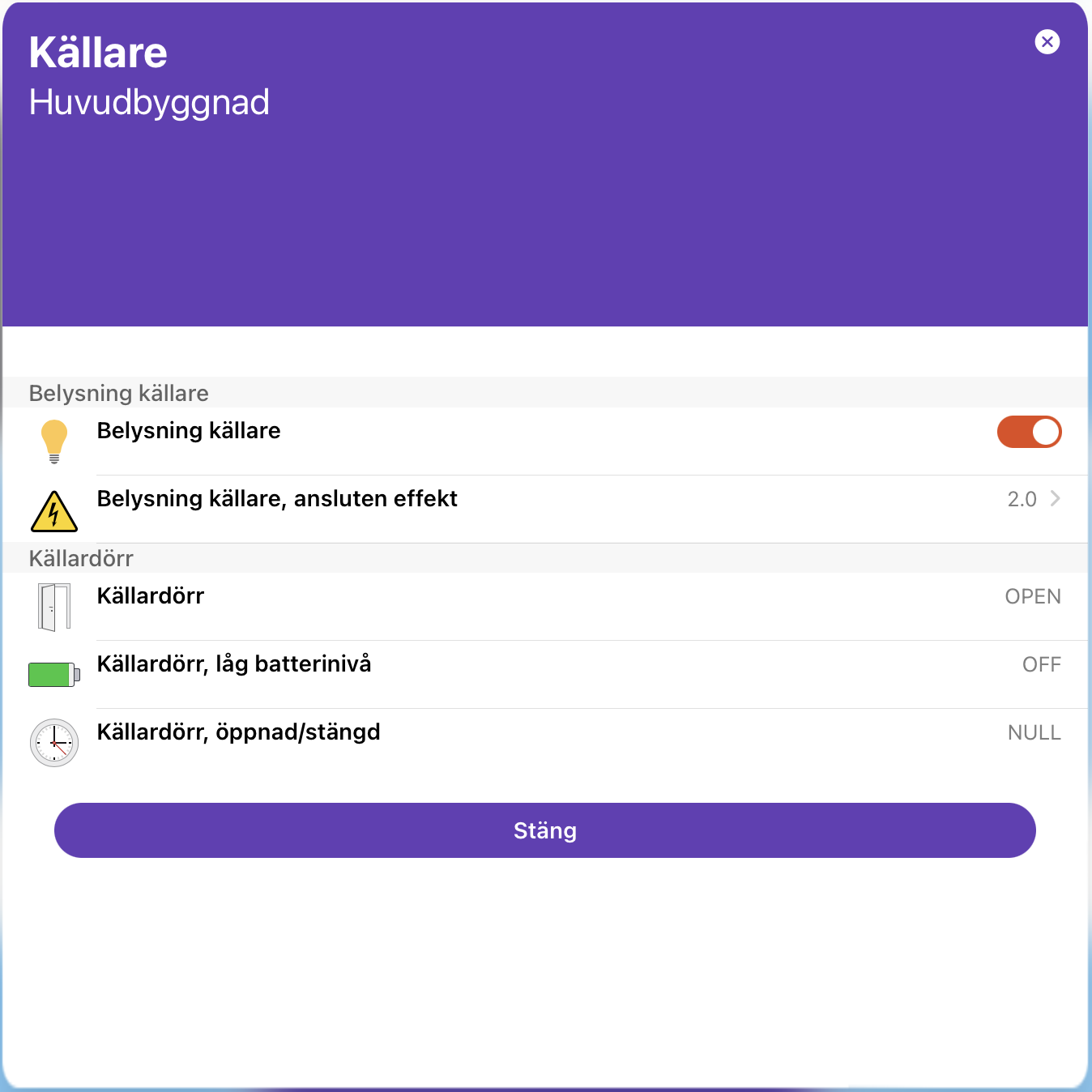

Issue: when looking at the room-card in the auto generated Locations tab, points in equipment doesn’t show up on the card together with number of lights turned on, temperature etc. as they do in the OH-demo. What to make out of this? It makes sense to use the equipment level to group things together, but if it improves functionality to skip the equipment-level, maybe that’s the path forward?

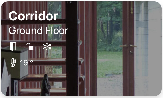

The door icon will only show up when the door is OPEN. If there are no open doors the icon does not appear on the card.
The number only appears when there is more than one OPEN door.

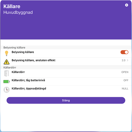

Not sure if I’m doing something wrong, but no points in equipment shows up like you describe. In my basement example I think both the light that is on and the door that is open should show up.

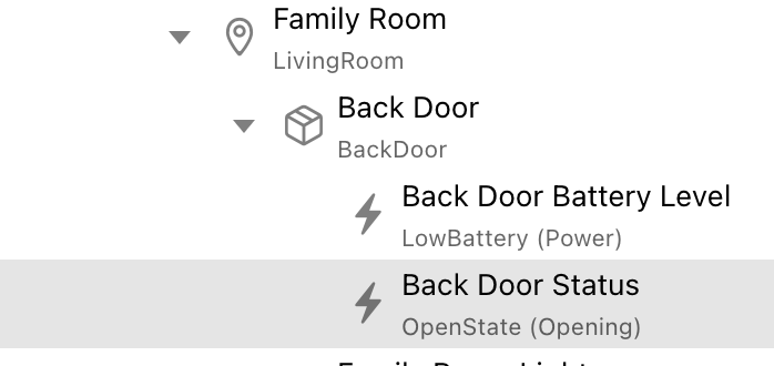

Example for your door, it needs to be configured this way:
Point_Status_OpenState isPointOf Equipment_Door hasLocation (the location)

Count those with the state OPEN: single result, display the icon only; multiple results, display the icon and the count.
Everything was configured correctly but still no luck so I decided to try Chrome instead and there it worked. After clearing the cache in Safari it worked there also… Many thanks for your help!
