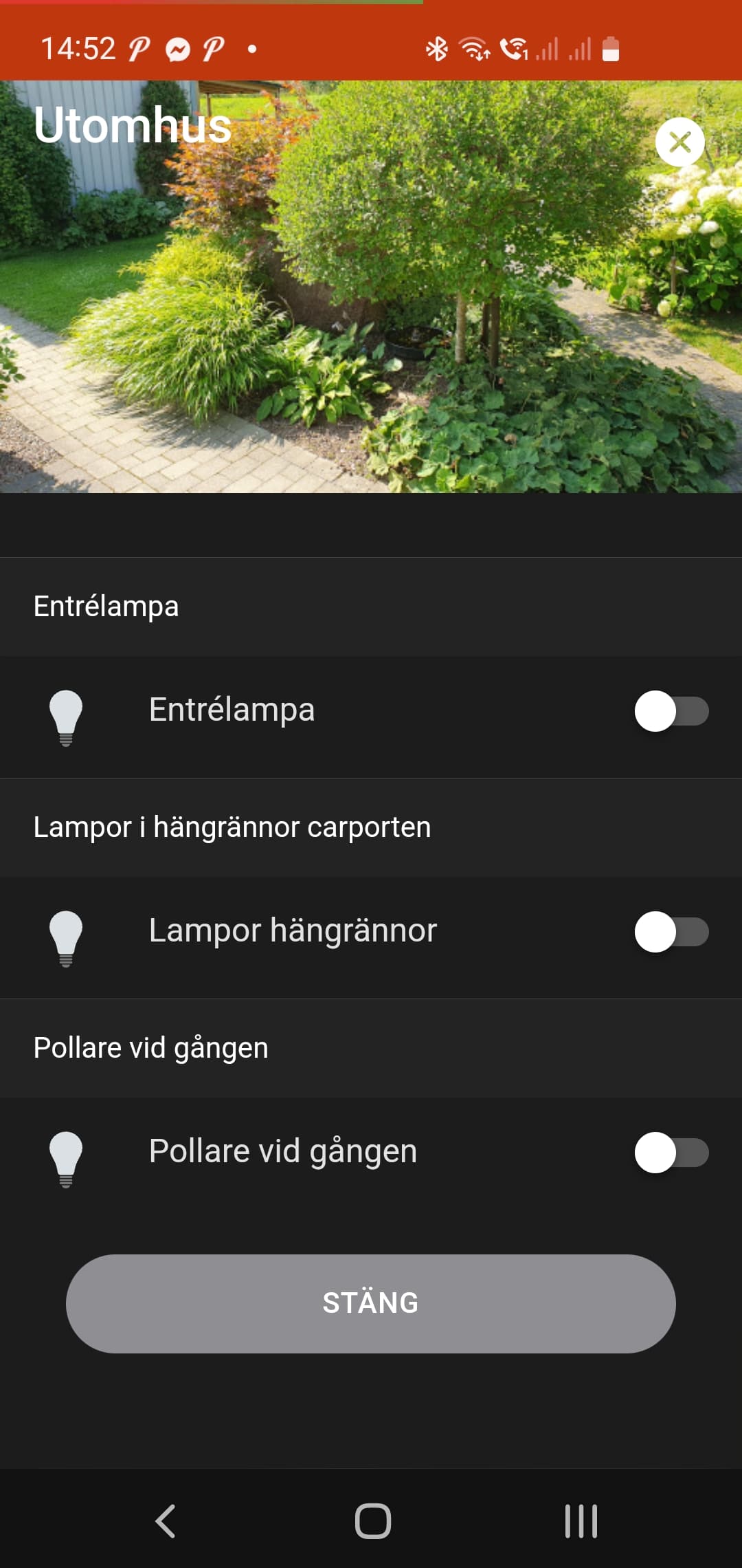

In some part of my house the only automation I have is light switches. That means in those parts I get lots of equipments that only have one point each, which I don’t think go well with the interface in the location tab. Either I go with the default and let all my points be named “switch”, which mean a long list where every other row just says “switch”. Or I name my points after what lamp they control, but it isn’t much better, see attached image.
Is there any other way to visualize those equipments with only one point? Or any other way to do this look nicer?

Some of your options to manage this include:
  • put all the lights in one location into one Equipment instead of many
  • get rid of the Equipment entirely and make the lights direct members of the Location
  • there are a few properties you can set on how the the equipment are displayed; go to the Overview page and click the pencil icon in the upper right corner and see if any of those options work for you.

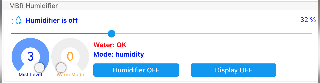

The primary use of the semantic model is to control how these Overview tabs get populated. So dont’ be afraid to exeriment with different hierarchies, visibility, and default list Item metadata to get you to what you want. For example, you could create one parent Equipment and hide all but one of the switches and create one widget with all the lights on one row. Just be careful to not go over one row in size. It mostly works but there is a bug (which I’ve reported) that makes the close and analyse buttons not work when the list Item widget is too tall. I still use them though.
That’s how I show my humidifier.
That one widget shows nine Items. I put this widget as the default list Item widget for one fo the Items and set the visibility in the default list Item widget for the remaining eight Items to false.

Yep, this is absolutely the nicest and easiest way to go for me here. Just a single “lights” equipment and then put all the points beneath that. Thanks!
