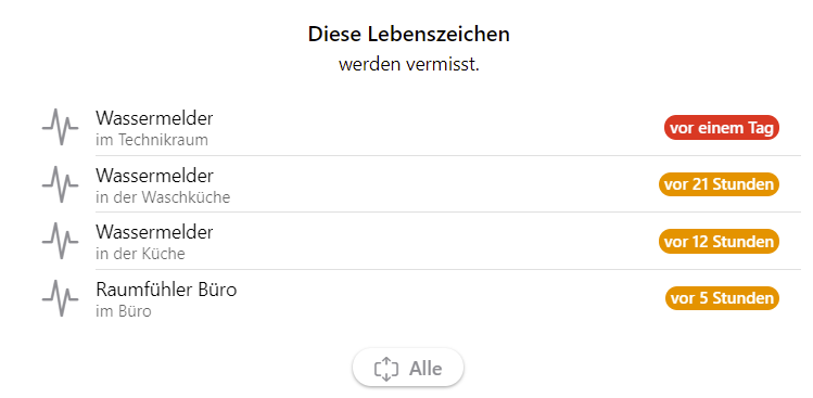

In the thread linked above, I’ve created a list which hilights outstanding heartbeats from wireles sensors:

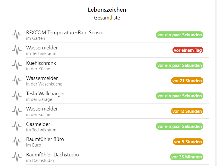

The initial attempt used a fixed timeout (1h) for warnings and another (1day) for errors.
This leads to some false negativ presentation:
While most wireless sensors report something every some seconds/minutes, I do have some sensors too which need quite very long periods of deep sleep to reach an acceptable battery lifetime:
  • Xiaomi Lumi Zigbee temp/hum/pressure sensors
  • Shelly Flood water sensors
  • Shelly Door Window sensors
See them in the above picture shown with orange or red badges…

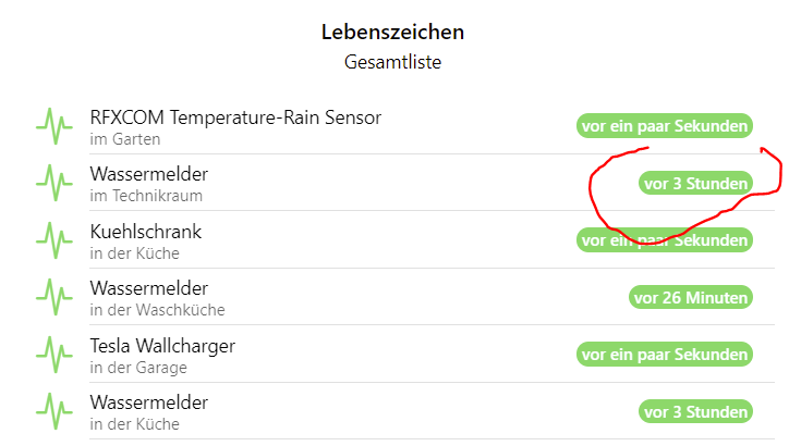

This brings us:
Notice the Shelly Flood “Wassermelder im Technikraum”. This guy was marked orange formerly. BUT: Since it is absolutely fine, if it sleeps for a whole day if no water alarm is to be issued, the widget should not complain about it…
Have fun … :wink:
