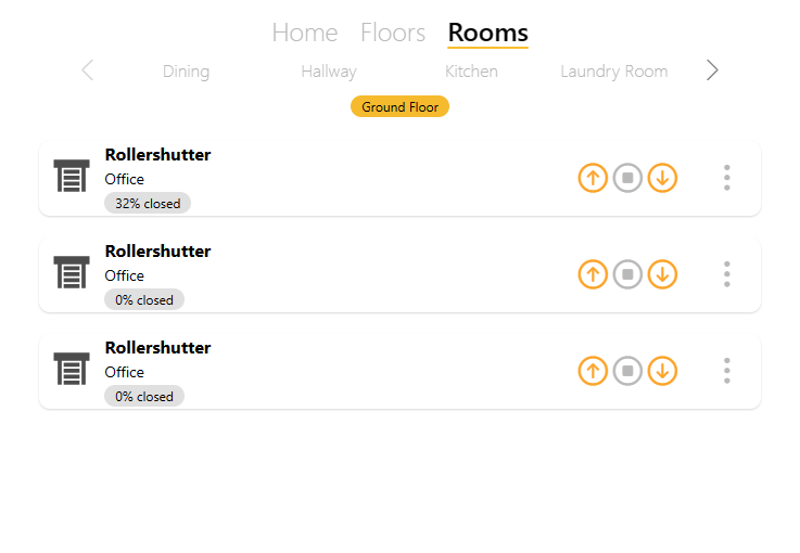

I have 3 Rollershutter in my office, where the controls are working perfectly however the name in the items is in the widget for all 3 items the same.
i just cant figure out why.

Thanks for your feedback. Reason is quite simple, your items have 100% identical uiSemantics.
You need to alter the equipment part, which is used for the name in the widget.
thanks a lot.
overlooked this part :man_facepalming:

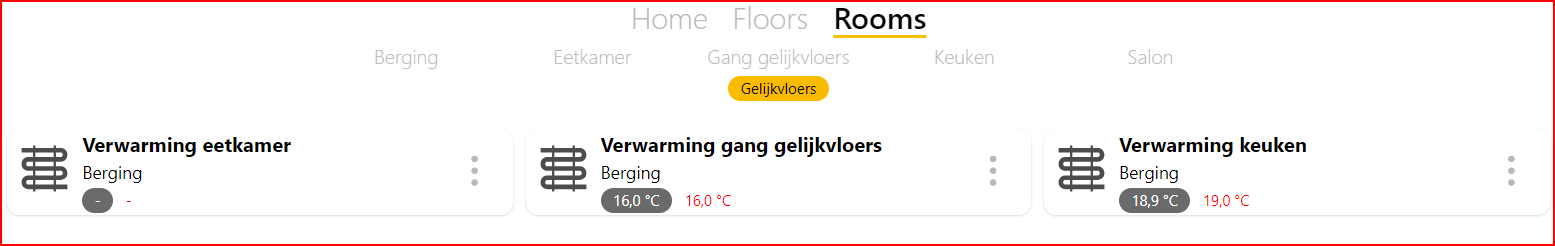

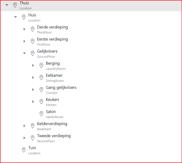

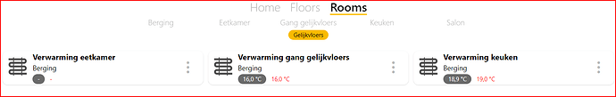

My RadiatorControls are all placed in the same room, being the alphabetically first room of the floor in question:
Here Berging is the first room (alphabetically speaking), but the heatings are in resp. Eetkamer, Gang gelijkvloers and Keuken. There is no heating in the Berging
Any idea what the problem is here? (I think the actual names of the room items are not used in the yaml code?)
I need to see your equipment group definition.
Seems to be missing or incorrect uiSemantics.

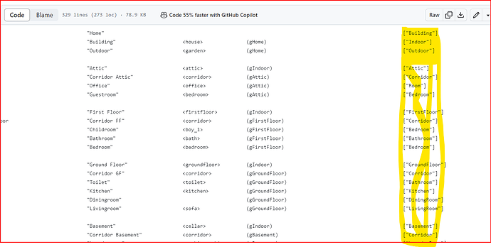

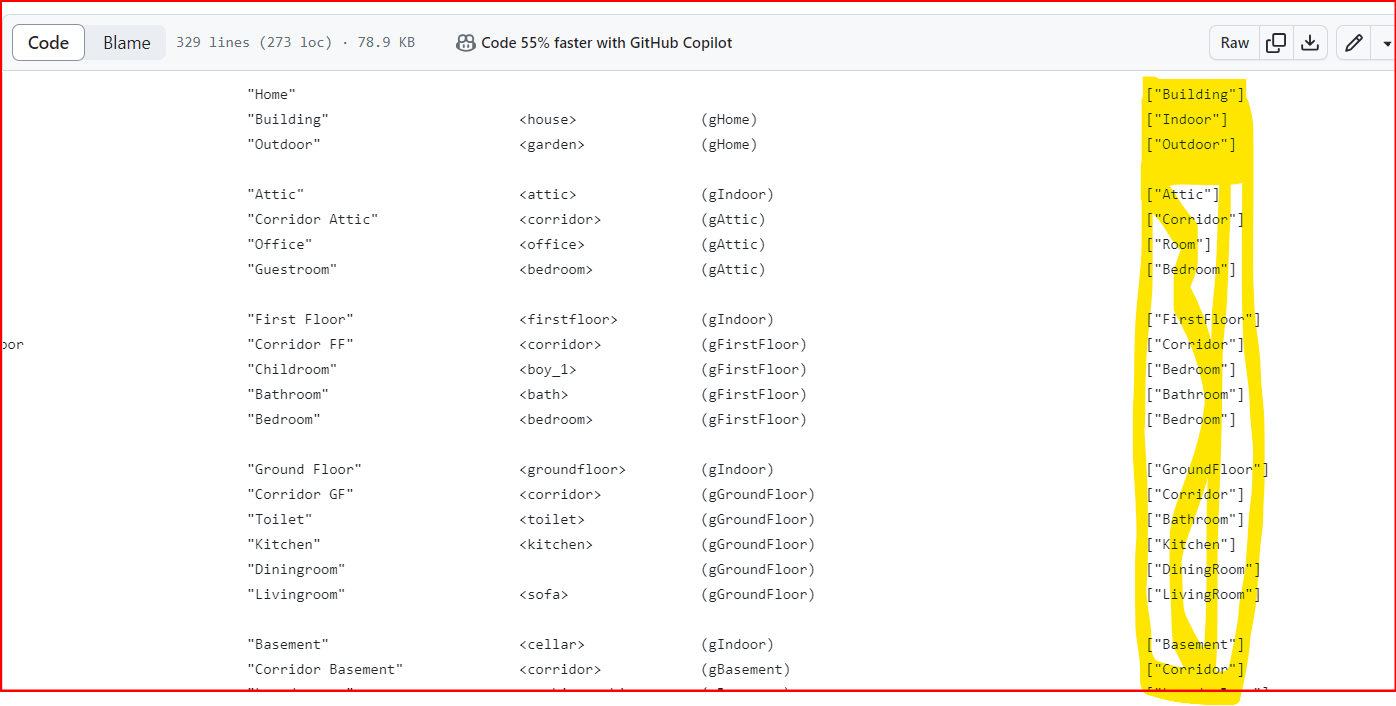

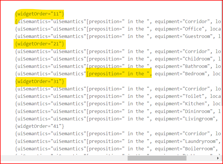

In the demo overview (semanticHomeMenu/demo.items at main · hmerk/semanticHomeMenu · GitHub), what is the 6th column for? I can’t figure that out:
Those are the semantic tags, defining what room type or what kind of equipment you want to define.

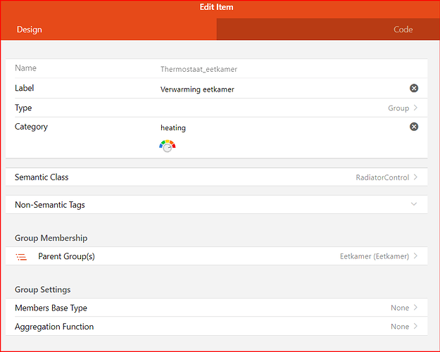

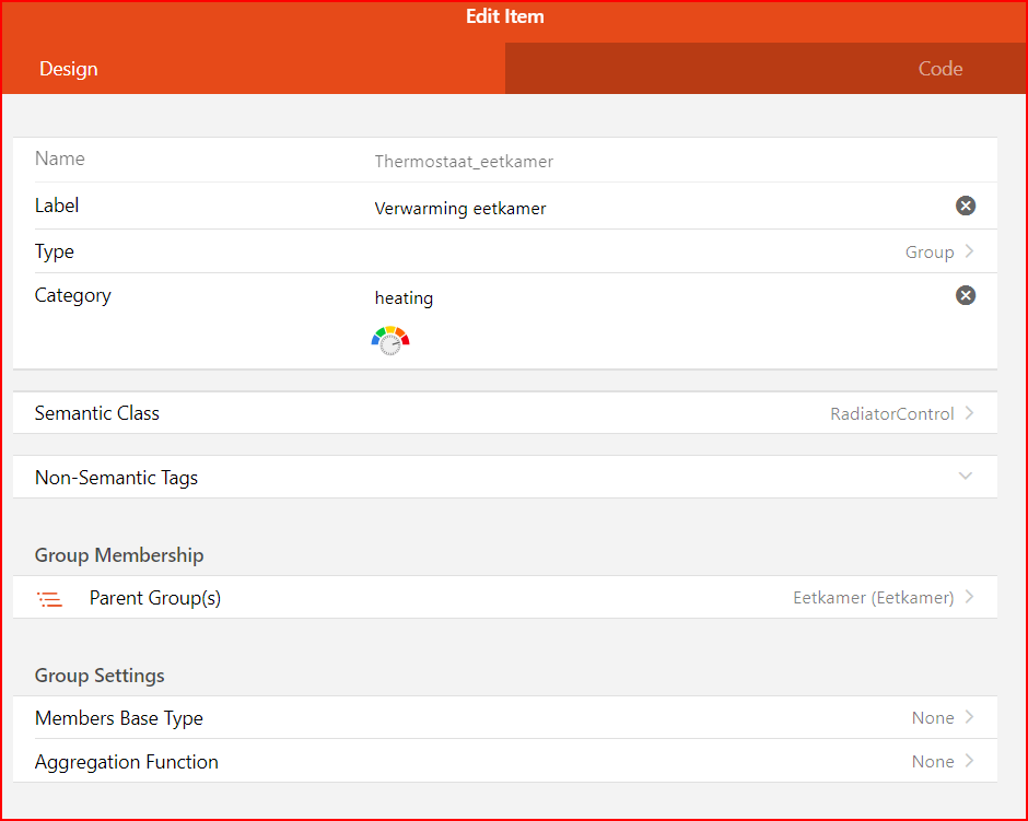

But I need to see the equipment items for your radiator controls.
And please do not compare to the demo.items file on github, but check the examples in the marketplace posts. Need to update some github files.
label: Verwarming eetkamer
type: Group
category: heating
groupNames:
  - Eetkamer
tags:
  - RadiatorControl
groupType: None
function: None
Noted. Didn’t realize they had examples…
How do I add the order (and the prepositions) via the MainUI?
Both are metadata values. When you open the item in MainUI, the is a menu for adding them.
