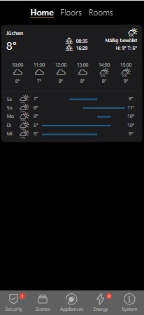

The Menu is split into a Top Navigation Bar,
grafik
grafik
the Body showing multiple specialized widgets (which are shown if the model contains the needed data)
and the the Bottom Navigation Bar.
grafik
Bottom Navigation Bar with Scenes selected
grafik
The red indicator badges are shown if there is any alarm, whether security or low battery. Usage and setup will be explained in the security and energy widget documentation.
