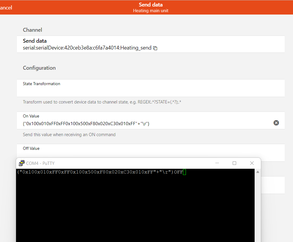

so sending is working, but command isn’t ok :
also OFF on the end isn’t required. But it isn’t critical, because is send when switch goes to off position
tried some other modifications, but still no luck send as correct HEX
Any idea how to send correct HEX command ?

Once you get the request command correct enter it into the On Value it should come out exactly as typed
OFF must be the default value for “Off Value” set it to \n which will just ask for new line.

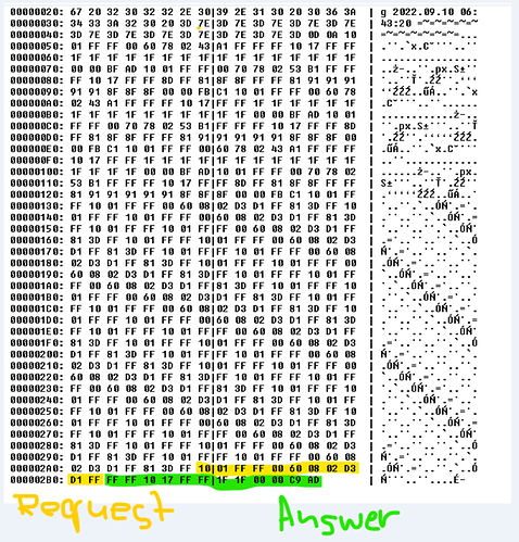

I already tested. Because I’m using USB/RS485 dongle, I can easy connect PC to the RS485 bus without any limitations and can see “online” communication.
I’m sure when I will send from original SW a command :
10H 01H FFH FFH 10H 30H F8H 02H E3H 61H FFH
Main unit will answer and send a data.
But when I will send this command from openhab, main unit will not answer

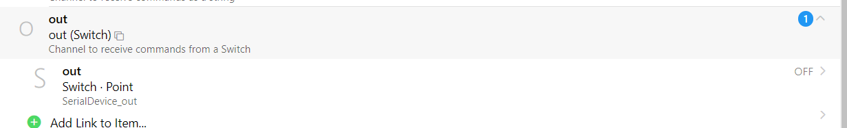

I have a channel receive:
and also send:

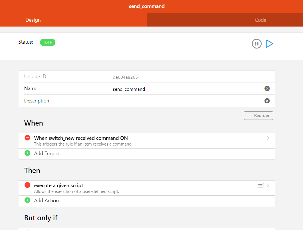

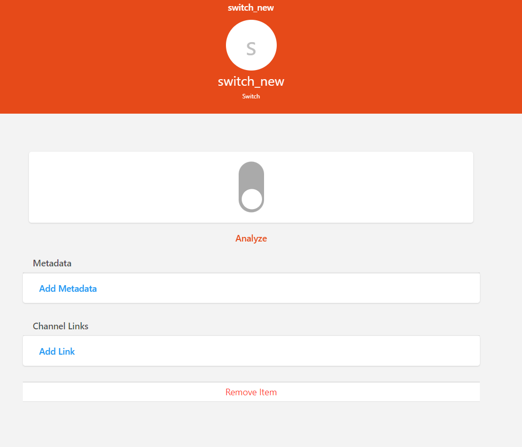

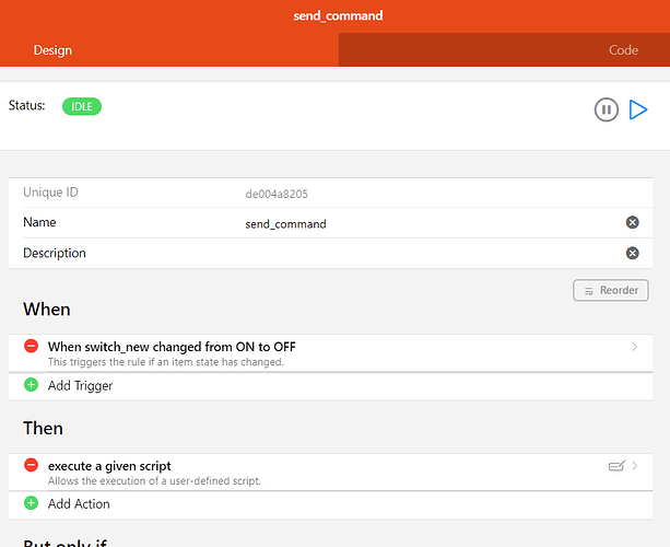

I created one special item switch for rule start:
and also rule:
with script:
but when I switch ON command isn’t send
I think I have wrong send channel defined. Also don’t know if it’s corrent that rule is in IDLE
I’m able get it working with switch configured:
but this isn’t good for my request

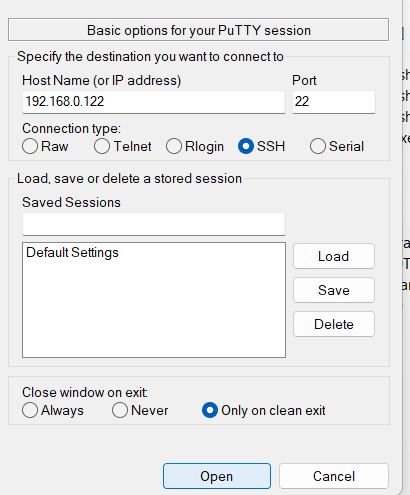

Regarding logfile: first I read a tutorial for loging. Instruction Is use file system or karaf. Who Is karaf? Ok karaf isn’t way for me, so file system. Ok file system Will do a online monitoring … Aha i can see a lot of instructions in tutorial. So clear is I must connect to console. Open tutorial for console. First information is: all depends how you started OH . For me not clear So i decided try connect via ssh. Ok, next part of tutorial. Information is: use port 8101. Ok i opened PuTTY And try IP + port. Connection refused. Next I tried port 8080. Also refused. Then I used default port 22. Ok password And name. Openhab And habopen… Refused, Wrong login. So this Is my situation. But also can write more details if it will help.

I will guess that you are running openHABian on a PI.
Connect to PI with PUTTY (e.g. "openhabian :openhabian ")
once you are connected to openHABian you can then connect to the openHAB Console
Enter ssh -p 8101 openhab@localhost onto the command line of the SSH session you have already opened

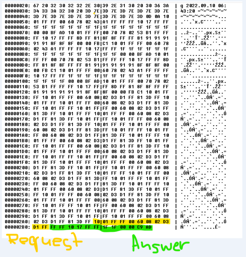

So putty: When communication is running looks like this :
so I must save a communication log and open in editor a switch to HEX view. Than I can see exactly what’s expected:

Regarding connection via putty :

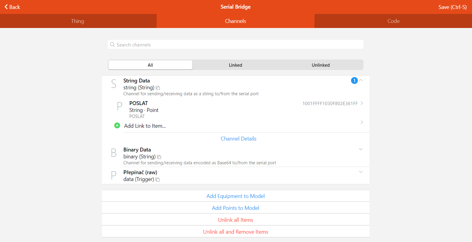

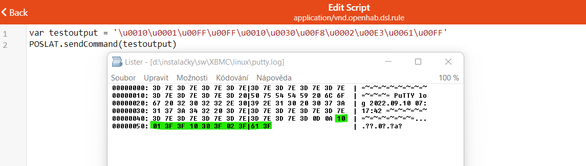

I created channel directly on the serial bridge :

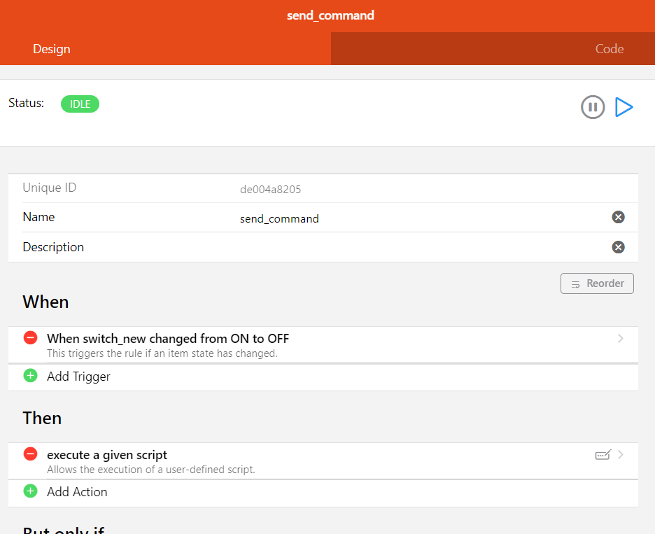

and modify a rule :
then it’s sending :partying_face:
but code isn’t correct :
FF sent as 3F, F8 sent as 3F, E3 sent as 3F - don’t know why
EDIT :
changed a charset :
and communication is working. Received back data. Running via serial bridge.
