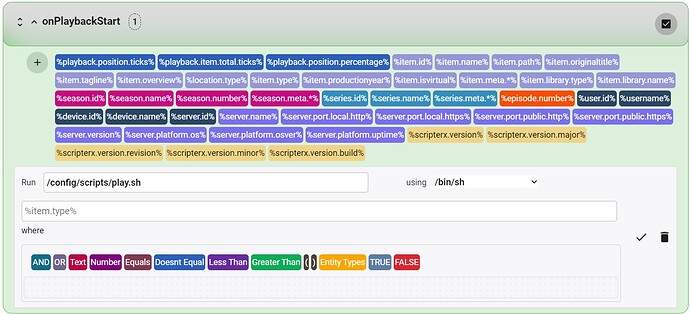

Go back to Emby’s dashboard and you’ll see Scripter-X → Action on the left side. Click on and find “onPlaybackStart”.
Add a new rule with the big + sign in the top left corner. Click on pen and type the following to:
Run:
/config/scripts/play.sh
using:
/bin/sh
and into parameter box:
%item.type%
Save it.

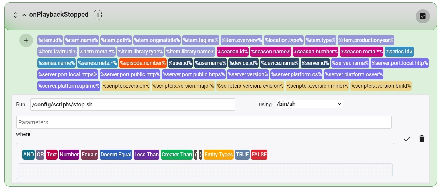

Do the same with “onPlaybackStopped”, but point the run path to stop.sh file and left parameter box empty.
Almost there. Now you can try it out from browser or any other client. But right now it will command openHAB any time and from any client if you play content off. It has to be limited to one device. How’d we do that? Easy. You see those little colored boxes. They work like drag and drop item in Windows. Go edit the settings.
Hoover your mouse over %device.name%, grab it and drop it into the “where” box. Also do it with “Equals” and “Text” below. Then click on text and write there your emby device name. Repeat on the “onPlaybackStopped”.
Whenever you want to add a new device, it is necessary to add new rule to the onPlaybackStart and onPlaybackStopped box with the new device name.
