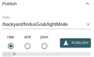

Here’s it working for me:
Result in MQTT Explorer:
Changing Grablicht in openHAB Sitemap
Now going the other way, publishing from MQTT Explorer:
Result in sitemap:
