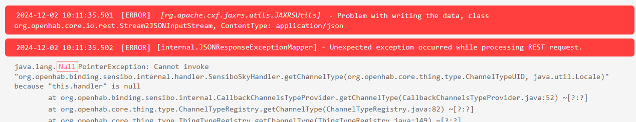

After upgrade to 4.2 I got a lot of error messages in the log do I deleted/created the things with the ”empty” result.
Now I have reverted back to 4.1 so it is no panic.
Best Regards, Valter

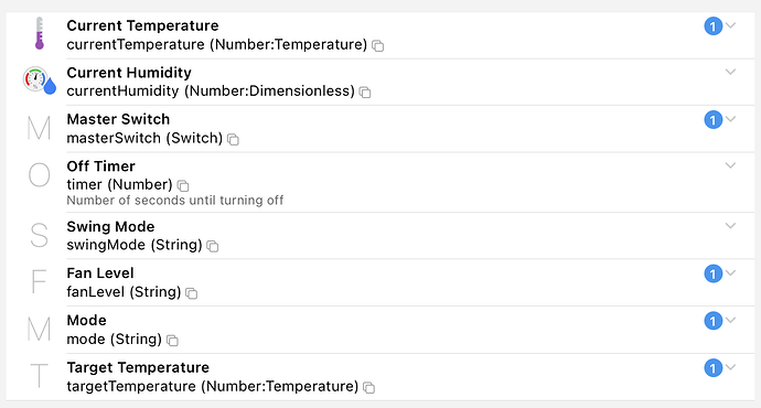

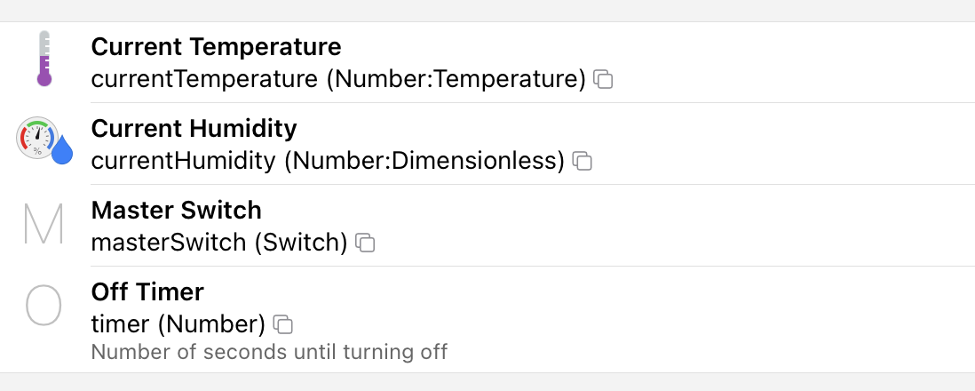

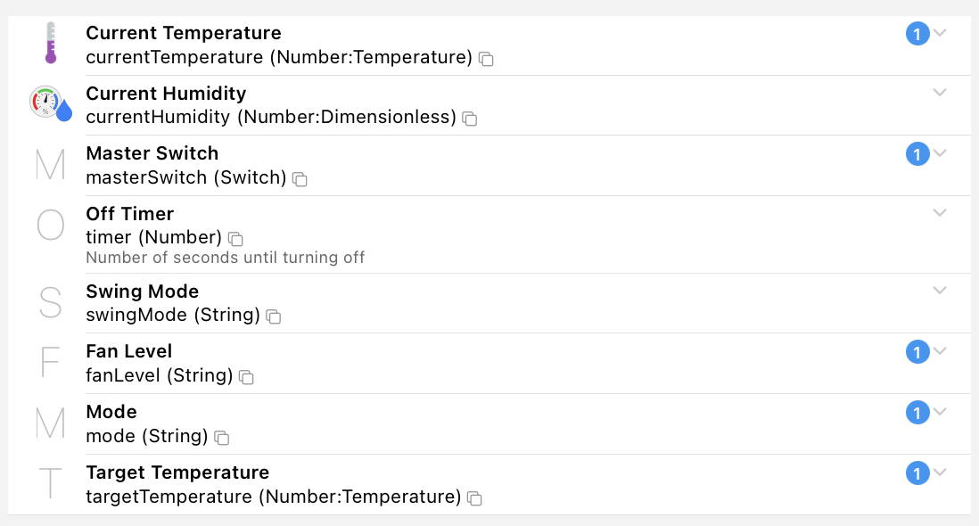

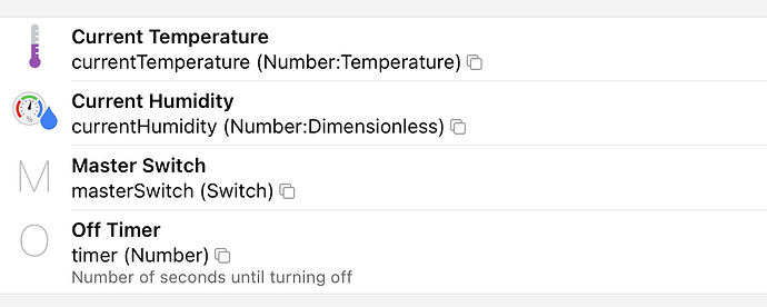

The 4.3.0-SNAPSHOT works but are missing some of the channels.
Compare the two pictures:

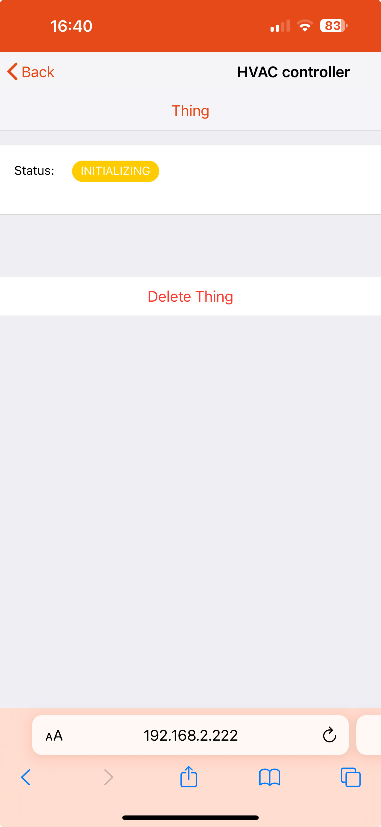

Did you try to recreate the HVAC thing?
If that does not help, please send DEBUG level logs.
BRG

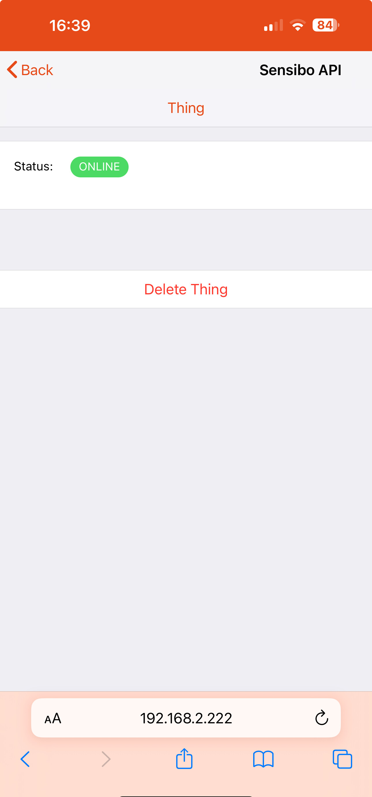

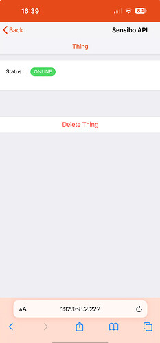

I removed the things and restarted openhab (actually rebooted the linux box)
Added “Sensibo API”

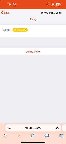

Added “HVAC controller”
The HVAC controller never gets finished and is still INITIALIZING
The log:
openhab.log (33.5 KB)
Seems like you have configured the mac address in lowercase while the binding expects uppercase.
