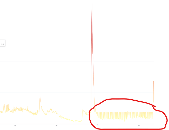

Since more that a week I’m pulling now values from to different sensor to my OH4.3-2 installation.
It was it looks nice.
Since yesterday I’m not more sure if I can reliable on thoose values from two DIFFERENT sensors.
One is for “air preasure” the other shows me the “durst in the air”.
The graphs look like this:
and this:
The change to an other sensor this morning show the same effect and the end of the bar.
Only up and down from the value…
Anyone has an Idea?

I’m still wondering whey it was working very well for more than a week and from on eto the other day the binding receives all thi kind of wrong values…
As the values coems from the sensor.community service two rootcauses are possible.
  1. The binding get’s the addinoal to the right once, wrong values with the TOP.
  2. The service sends wrong values.
I have added more sensors from differnet city, and all of them have the same problem.
I have already deleted the items, the thing and the binding, and have created them new.
Without success. Meanwhile the graph look linke this:
BR
Jochen
