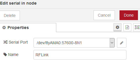

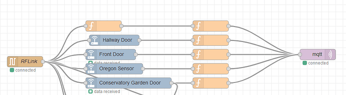

I use node-red with a serial node and the RF-Link nodes to pass messages to openHAB either through opneHAB nodes on via MQTT:
