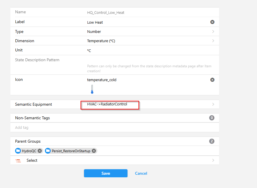

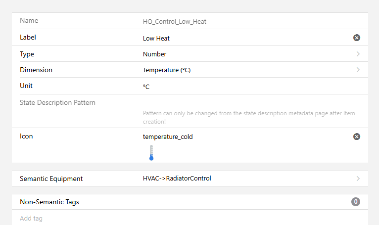

I did just find out that it’s working for other setpoint and that now, that specific setpoint doesn’t show the “,x” value in the slider. I did found out with the rest link you set that “pattern”:"%.0f” instead of 1f. Weirdly, in the ui, there’s nowhere it’s set, unless this set it:
Upon adding a state description in the UI, it now work. Weird that it doesn’t do it for all items.
No, it’s not the tag. As mentioned, bindings can push a default state description, and in absence of that, OH core will do that. State description metadata will just override that default. It’s a bit unfortunate though that the default state description is not shown in the UI.
Create an issue for it. Or right away a PR :slight_smile:

I did see when cloning them though that when I selected number then a description like temperature, it showed me the state description and I could set it right there. But if the item is already created, there’s a message saying it cannot be modified there and must be modified through state description. Maybe if at least, it would show as read only the current value
