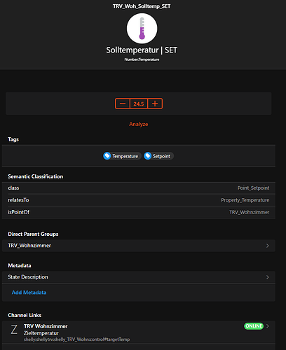

Hello community, I have a Shelly TRV set up with the Shelly Binding.
I have set up a setpoint number item as the item for the target temperature.
Problem:
I can only send integers as setpoint to the TRV. If I set the setpoint steps to 0.5 I get a parsing error.
How can I make it so that floats are also sent?
I can set 0.5 steps in the web interface and in the Shelly App.
Thanks for your support

I have linked the following item to the TRV Thing
Now I set the target temperature in 0.5 steps:

The TRV does not set the setpoint temperature to 24.5 °C but remains at 24 °C.
If I set the steps to integers it works.
