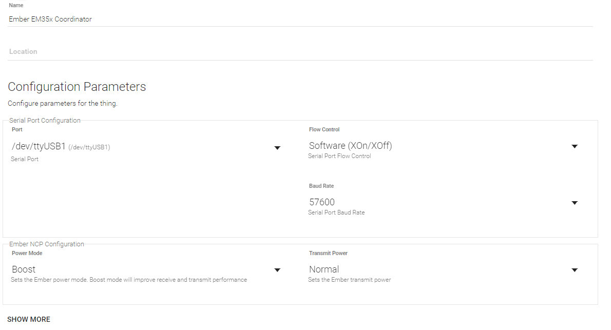

I finally got the device working in my system after reading lots and lots of posts so I thought I’d share my experience.
I’m running openhab 2.4 via docker via unraid.
First, I had to enable the usb device for the container. This is accomplished in Unraid by updating the container settings and selecting “Add another Path, Port, Variable, Label, or Device”.
Config type: Device
Name: anything you want (I chose zigbee usb)
Value: the usb location (mine was /dev/ttyUSB1). If you want to add the zwave controller too, also add ttyUSB0
Next, we need to set the environment variable EXTRA_JAVA_OPTS to the following:
-Dgnu.io.rxtx.SerialPorts=/dev/ttyUSB0:/dev/ttyS0:/dev/ttyS2:/dev/ttyACM0:/dev/ttyAMA0:/dev/ttyUSB1
In unraid, click “add another path, port…”
Config type: Variable
Key: EXTRA_JAVA_OPTS
Value: -Dgnu.io.rxtx.SerialPorts=/dev/ttyUSB0:/dev/ttyS0:/dev/ttyS2:/dev/ttyACM0:/dev/ttyAMA0:/dev/ttyUSB1
In openhab, here are the settings used for the binding:
Just to be clear, I’m an openhab novice myself, but I hope this is useful for someone in the future.
