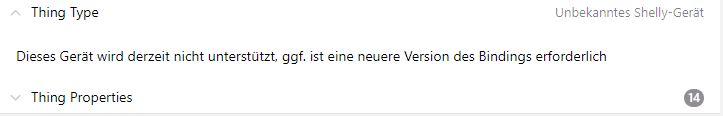

I was on OH 3.3 (Windows 10) until I updated to 3.4.3 today due to my new Shelly Plus Plugs were not supported by former binding version. After the update, I unistalled the official Shelly binding, did feature:install openhab-transport-coap via console and put org.openhab.binding.shelly-3.4.3-SNAPSHOT into addons folder. After restarting OH, all Shelly things showed up Error:Handler (not sure about the exact wording). I then tried to install Shelly Beta from Marketplace, but I got the same error-message in Main UI as mentioned a few times at the beginning of this thread (Installation of add-on marketplace:139554 failed). I then went through this thread compeltely and recoginzed that the official binding does support plus devices also. I then deleted the jar and installed the official binding again. All existing Shelly Things come back online, and the plus plugs were found by autodiscover. However, both plus plugs are shown offline and following errors are shown:
shelly1
English: IP-address of shelly device not configured
English: the device is currently not supported. A newer version of the binding might be required.
Clearing cache and tmp, restarting OH and Windows did not help. Any hint what to do now?

However, my plus plugs are auto-detected but still not working (see screenshots above). @markus7017 - may I send you TRACE logs per PM?
You need to use the DEV build, this is linked above. The market place installation doesn‘t work. I assume a syntax error in the definition, but couldn‘t figure out the problem.
Download the 3.4.3-SNAPSHOT jar
remove the version, which comes with the dist
re-install the coap transport feature
copy jar into addons folder
run discovery

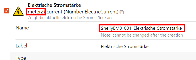

On autodiscover of shellies (Shelly3EM in this case) with the shelly beta binding I have following issue: there is no differentiation between the separate meters of some items!
For example the electrical current for meter 1:
…for meter 2:
… and for meter 3:
They all have the same name. Do I have to change that manually to seperate between the different meters? Or did I a mistake?
Many thanks in advance for your help!!
Just assign different names
Ok, thanks!

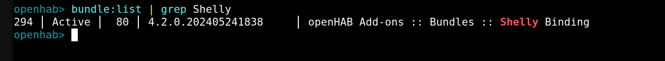

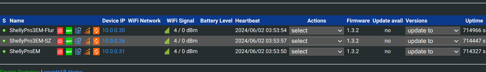

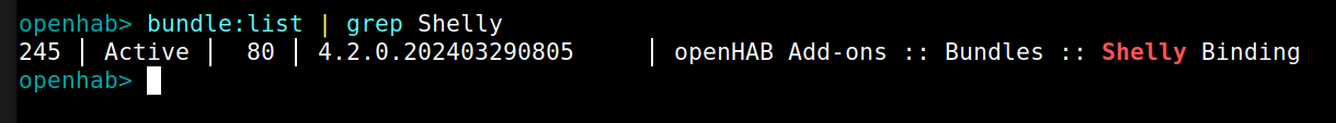

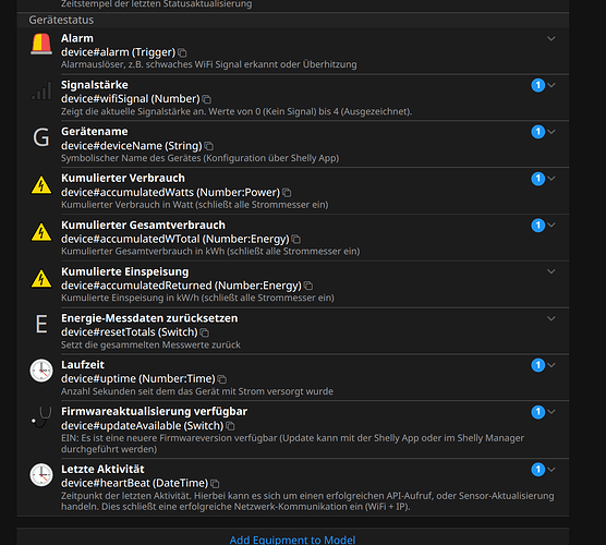

I have 2 ShellyPro3EMs in use. One finds more items than the other. Temperature is missing, for example. Firmware is 1.3.2 on both. Do you happen to know what could be wrong? Binding version is 4.2.0.202403290805.
Thanks in advance
Shelly-1.pdf (290.1 KB)
Shelly-1.txt (6.4 KB)
Shelly-2.pdf (256.2 KB)
Shelly-2.txt (5.4 KB)
please update to the latest DEV build
4.2-DEV | 4.1-DEV | 4.0.-DEV | 3.4.5-DEV | README | READMEbeta
Avdanced Users - Shelly Manager - Bugs/Features - API Doc | Firmware Index - Firmware Archive
Note: The DEV build is always newer than the version in the official Distro or Milestone builds. Current development is based on 4.2-SNAPSHOT, 4.0.x and 3.4.x are outdated.
Hi Markus,
I have installed the latest build. Unfortunately no change.
Regards
