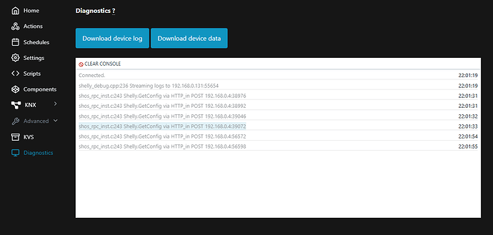

Since a couple of days my shellies also no longer reliably work with openHAB. Sometimes they don’t react at all, sometimes they do with a delay of about 15 seconds (estimated). I haven’t dug any deeper so far but I think this might be related.
EDIT: actually I think this was more Alexa related… I will observe further…
EDIT: No it’s not just an Alexa thing. It also happens in my local network with a direct OH to Shelly connection.
192.168.0.4 my openhab server is bombarding the shelly
Cannot see this on a Shelly 1PM with latest firmware:
shelly_notification:162 Status change of switch:0: {"id":0,"aenergy":{"by_minute":[696.778,693.909,691.450],"minute_ts":1742809860,"total":175525.495}}
10:51:00
shos_rpc_inst.c:374 0x3ffe0ab8: duplicate id 'openhab-192.168.1.209'
10:51:14
shos_rpc_inst.c:243 Shelly.GetStatus via HTTP_in POST 192.168.1.209:60568 user admin
10:51:14
shos_rpc_inst.c:243 Shelly.GetStatus via HTTP_in POST 192.168.1.9:34540 user admin
10:51:16
shos_rpc_inst.c:374 0x3ffdf68c: duplicate id 'openhab-192.168.1.184'
10:51:55
shos_rpc_inst.c:243 Shelly.GetStatus via HTTP_in POST 192.168.1.184:48918 user admin
10:51:55
shelly_notification:162 Status change of switch:0: {"id":0,"aenergy":{"by_minute":[700.467,696.778,693.909],"minute_ts":1742809920,"total":175526.195}}
10:52:00
shos_rpc_inst.c:374 0x3ffddc8c: duplicate id 'openhab-192.168.1.209'
10:52:14
shos_rpc_inst.c:243 Shelly.GetStatus via HTTP_in POST 192.168.1.209:52890 user admin
10:52:14
shos_rpc_inst.c:243 Shelly.GetStatus via HTTP_in POST 192.168.1.9:41038 user admin
10:52:17
shos_rpc_inst.c:374 0x3ffde9f0: duplicate id 'openhab-192.168.1.184'
10:52:55
shos_rpc_inst.c:243 Shelly.GetStatus via HTTP_in POST 192.168.1.184:57786 user admin
10:52:55
shelly_notification:162 Status change of switch:0: {"id":0,"aenergy":{"by_minute":[701.697,700.467,696.778],"minute_ts":1742809980,"total":175526.897}}
10:53:00
shos_rpc_inst.c:374 0x3ffde9f0: duplicate id 'openhab-192.168.1.209'
10:53:15
shos_rpc_inst.c:243 Shelly.GetStatus via HTTP_in POST 192.168.1.209:45658 user admin
10:53:15
shos_rpc_inst.c:243 Shelly.GetStatus via HTTP_in POST 192.168.1.9:53452 user admin
10:53:17
10:53:55
shos_rpc_inst.c:243 Shelly.GetStatus via HTTP_in POST 192.168.1.184:60212 user admin
10:53:55
shelly_notification:162 Status change of switch:0: {"id":0,"aenergy":{"by_minute":[700.877,701.697,700.467],"minute_ts":1742810040,"total":175527.598}}
10:54:00
10:54:15
shos_rpc_inst.c:243 Shelly.GetStatus via HTTP_in POST 192.168.1.209:43996 user admin
10:54:15
shos_rpc_inst.c:243 Shelly.GetStatus via HTTP_in POST 192.168.1.9:48814 user admin
10:54:17
10:54:55
shos_rpc_inst.c:243 Shelly.GetStatus via HTTP_in POST 192.168.1.184:34570 user admin
10:54:55
shelly_notification:162 Status change of switch:0: {"id":0,"aenergy":{"by_minute":[700.467,700.877,701.697],"minute_ts":1742810100,"total":175528.298}}
10:55:00
