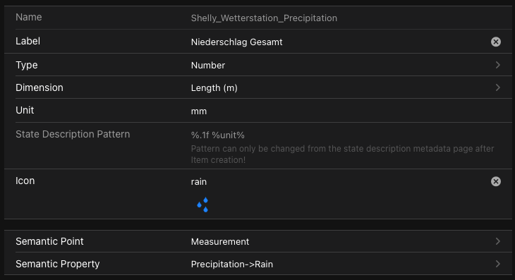

usually the icons are derived from semantic tags. I included those in the channel definition.
let check this later
It’s Number:Volume, which is by default m3. I added the code to update the channel and specified mm. Check after first channel update.

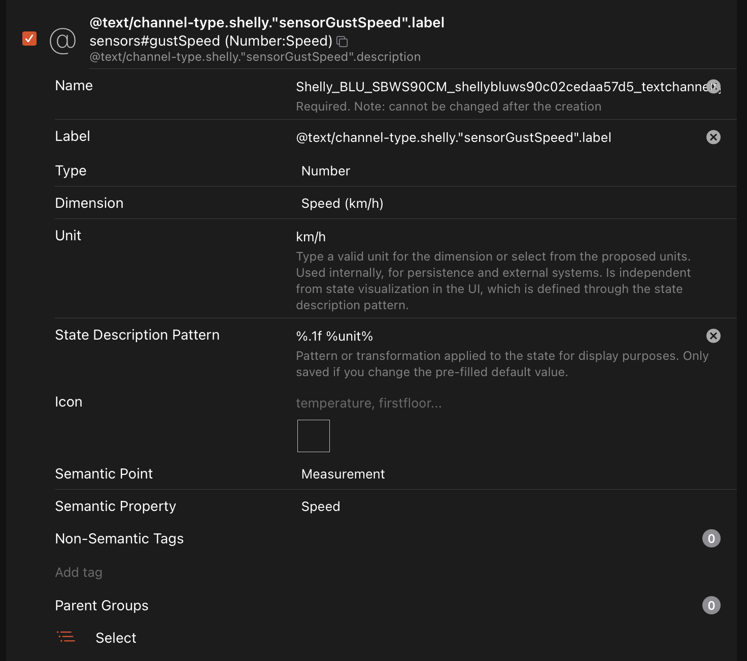

channel update for pressure, uv index, wind speed, gust speed were added

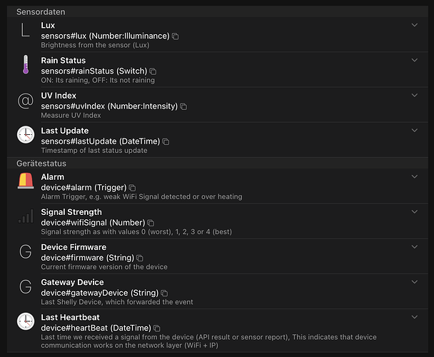

Hi @markus7017,
thanks a lot! It is working much better, but still having issues with wind speed and gust, dew point.
openhab.log (977.9 KB)
In this test setup, there is only one plug s installed and the weather station itself. So hav a look at the log file. Dew Point values are in the log, but not wind or gust speed. I know from my mqtt script, that the weather station is publishing these two values nearly every 30s, or less.
I think, the illumination channel can be deleted, because the WS90 is not delivering this only the lux values.
If you need more, tell me.

I found issues with dew point, and wind speeds; illumination channel will no longer created
please check
Thank you! I think now we have it with the weather station. Only small one is, that perception is still m3 / volume and not mm / length . Here is a screenshot how I use it, perhaps you can set this as standard for the channel:
Also at the moment Wind and Gust Direction Channels are missing.
