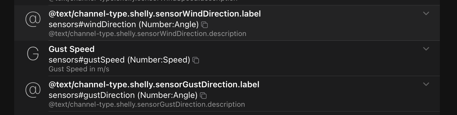

thanks a lot for the DEV update. The WS90 channels get created and update just fine. I see the same issue on the direction channels as described by @alaub81

DEV builds are updated to fix channel naming and the Websocket Error
Hi @markus7017
thanks, but I don’t see any change. I did upgrade to the new version and see both issues still, the channel naming and the WebSocket error.

Hi @markus7017
thanks, I updated to the latest DEV build and can confirm the channel names as well as the unit being fixed :+1:

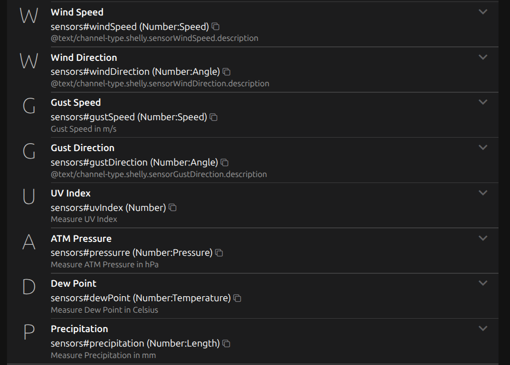

Also, adding the Item for Precipitation is still not good. By default a Number type is proposed. Changing this to Number:Length leads to UNDEF:
2025-12-20 13:58:39.420 [INFO ] [openhab.event.ItemStateChangedEvent ] - Item 'WS90_Precipitation' changed from NULL to UNDEF (source: org.openhab.core.thing$shelly:shellybluws90:286847efaefb:sensors#precipitation)
Anyhow, pretty close!
crap, it seems that also this fix got lost, check updated DEV build
Hi @markus7017 latest dev build looks good so far! BLU Gateway devices also stable again.
3 things, I found in my 5min test for the WS90:
  • Wind and Gust Direction are set as km/h , they have to preset to angle °
  • Precepation should set to length and unit mm
