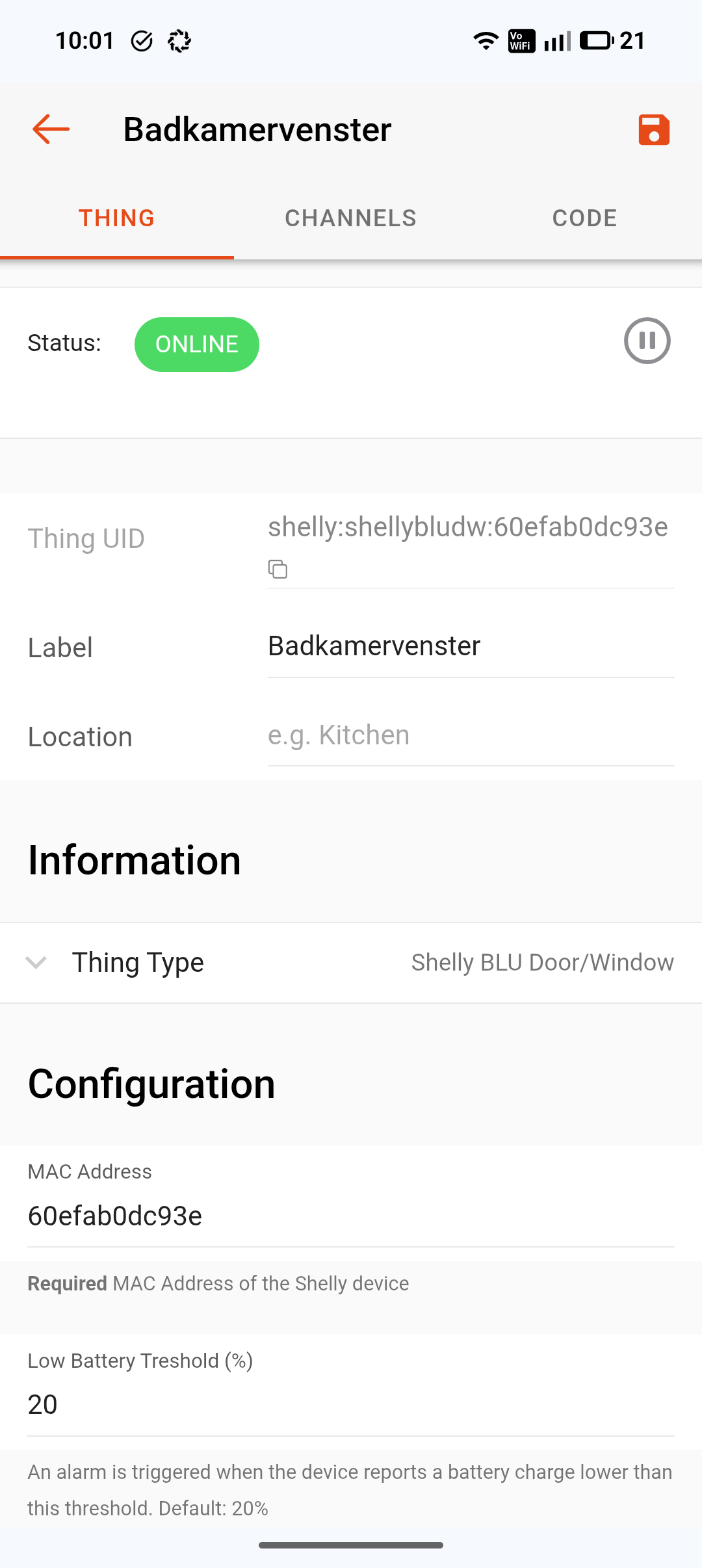

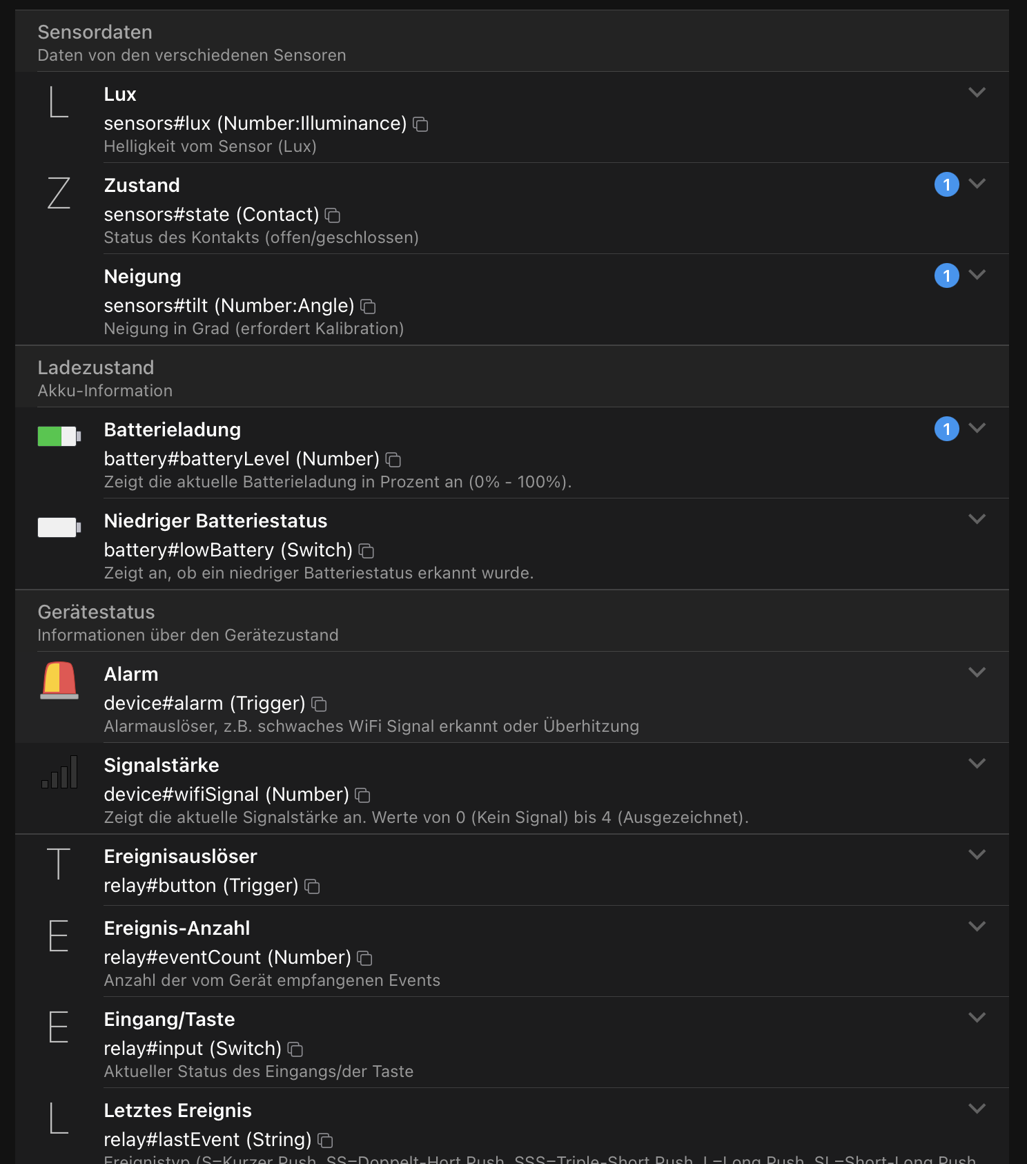

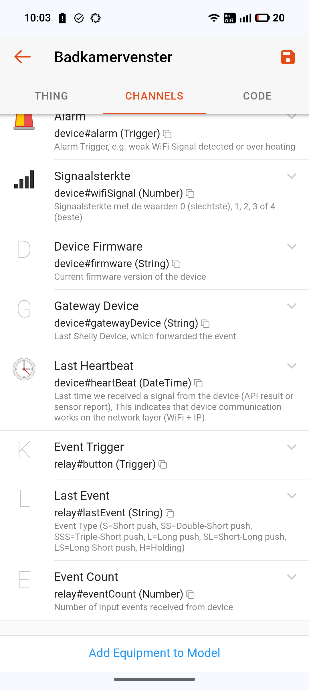

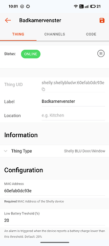

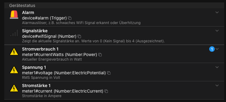

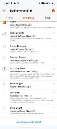

@markus7017, is it possible something went wrong with the Shelly BLU Door/Window things?
It doesn’t have the proper channels. Instead, it has the channels of a BLU Button

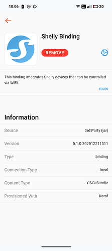

But:

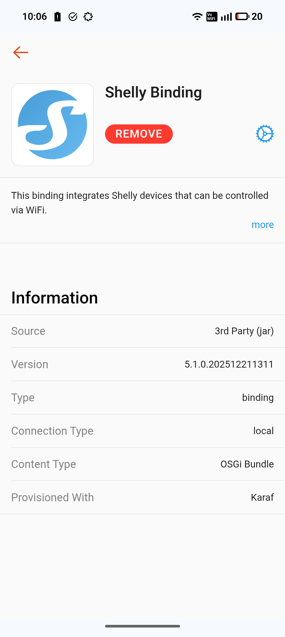

Now I am on openHAB 5.1.0 with dev binding:
openhab> bundle:list | grep -i shelly
249 │ Active │  80 │ 5.1.0.202512211311    │ openHAB Add-ons :: Bundles :: Shelly Binding
that’s working on my side. I didn’t delete my things, so on my side door window blu devices are working still fine. But can also see some channels which are wrong I think:
I think this statement was inaccurate. Or at least now (with the official binding), the proper channels are there. The eventchannels are still there, but maybe they relate to the button on the BLU Door/Window?
yes the DW has a button and channels are added automatically

Is the thing ONLINE? (The BLUDW also has a button)
Channels get created when thing goes online

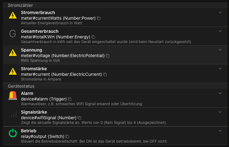

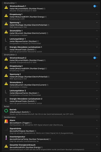

but there is no total kWh channel.
And I know there is like on the other pm devices an output for that. I am using the device via MQTT at the moment.

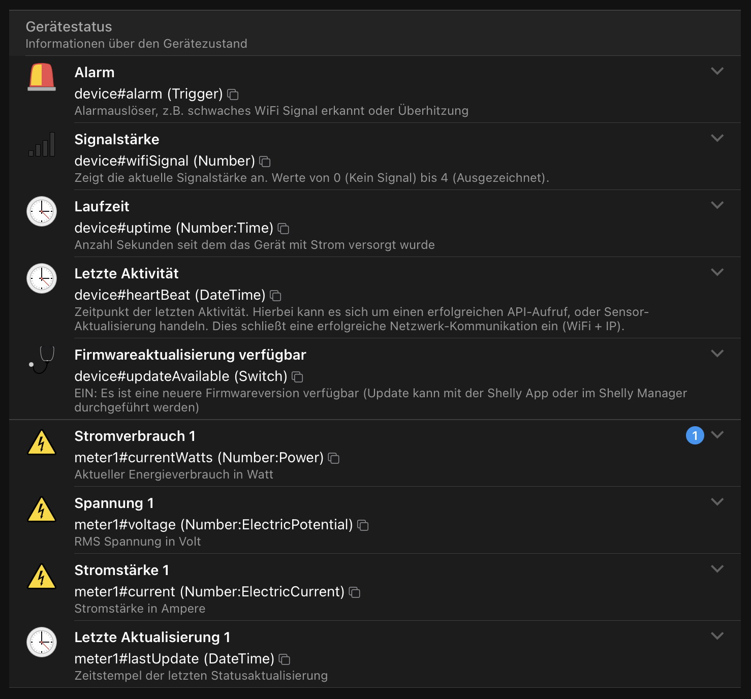

I tried the new dev build: 5.1.0.202512261525
50em has now a totalkWh channel, but not for meter 1 and meter 2. There it has only the returned kWh as a channel.
The WS90 is not recognized any more. I deleted the old Thing which was uninitialized, but no new device is coming to the autodiscovery. –> after disabling and enabling all my BLU GW Things, it appears in the inbox.

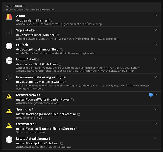

Yesterday I added the channel #totalkWh - It returns 0.0 kWh even though the device has been running for more than 2 years. Will I have to do a restart of the device to update this?
The channel for Uptime doesnt seem to work at all. This has been configured for more than two years, bu it still returns -:-:- -.-.-
Last heartbeat works fine though.
