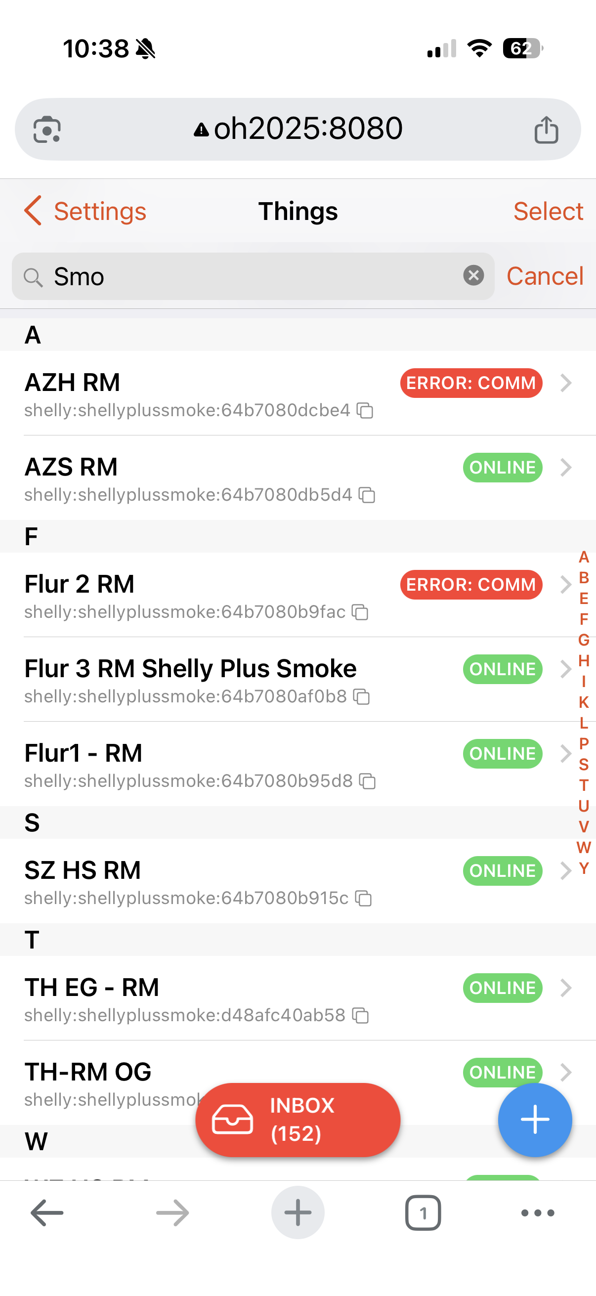

After approx. two days I am here with the Smoke Sensors:
With the binding:
Rest of the devices or online and working.
I have 2 smoke sensors, too. All good on my side. Perhaps check if the correct outbound web socket connection is set on the devices.
What is the different between this one which is online, and the Rest?
Thanks for the reply. I just checked the outbound websocket. All devices have got the same settings:
  • Enabled
  • ca.pem
  • ws://:8080/shelly/wsevent
Is this correct?
IP address of your openhab server is missing. or did you delete it to anonymize it?
Yes. Sorry.
I can not see any difference.
Nevertheless, I now delete all smoke things and re-added them. Let’s see what will happen.
I Guess the difference is the openhab version…I am using the new oh5.2 snapshot already
That is true. I am on OH 5.1.4.
But, after deleting and re-adding the things, this morning they are all online.
