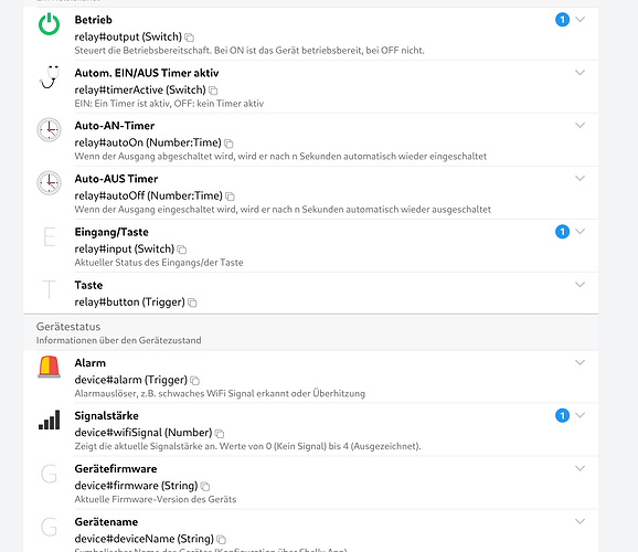

@Larsen do you even have the energy channels and voltage channels available on the Shelly 1 plus pm?

Hello. I can confirm, that I have had and still have on all my plus 1PM the energy / power as well as the voltage channel active and running.

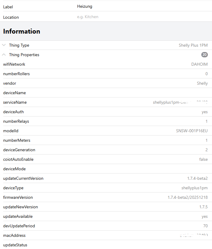

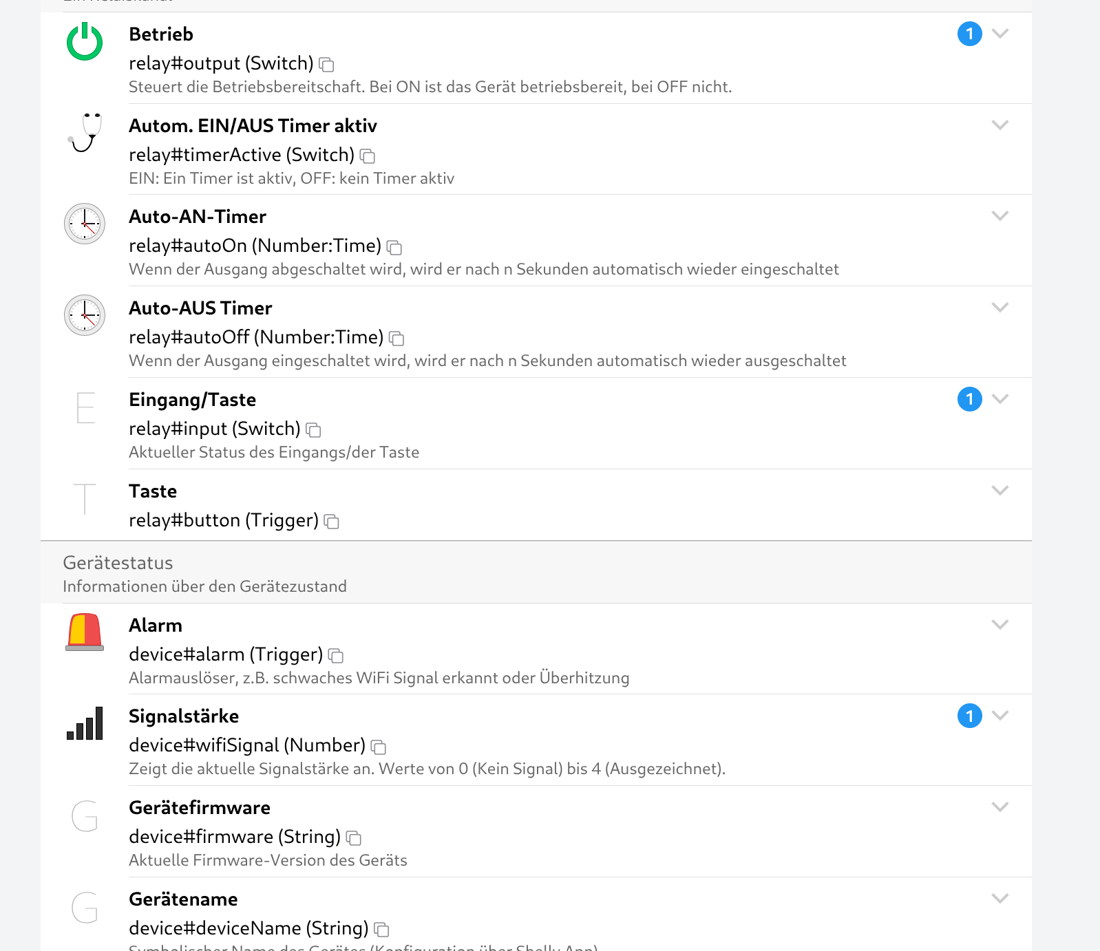

but i don’t see it
5.2.0.202605030737
and OH5.2 snapshot

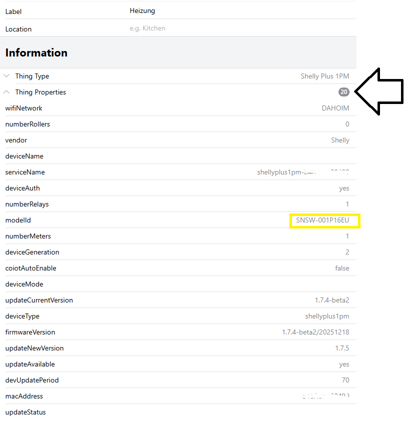

  • What happens, when you click the Thing properties.
  • Is you model supported by the binding and ID’s (check documention for supported models)
  • Delete the thing and all belonging items (channels) and create them new, automaticly or manual.
so here its is
* SNSW-001P16EU
if you delet it and add them sometime the voltage channels and enery channels appears sometime not

Deleted the cache stopped everything deleted the cache reloaded and rebooted same behavior

Same behaviour…I don’t know does it help to get some logs?

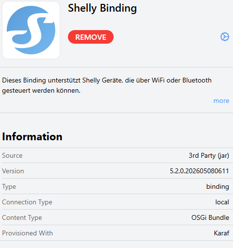

openhab> bundle:list | grep -i shelly
368 │ Active │  80 │ 5.2.0.202605080611    │ openHAB Add-ons :: Bundles :: Shelly Binding

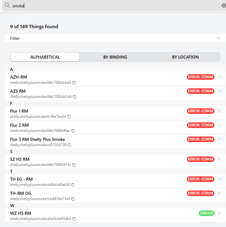

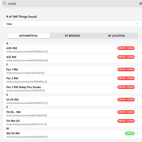

After approx. two days I am here with the Smoke Sensors:
With the binding:
Rest of the devices or online and working.
I have 2 smoke sensors, too. All good on my side. Perhaps check if the correct outbound web socket connection is set on the devices.
