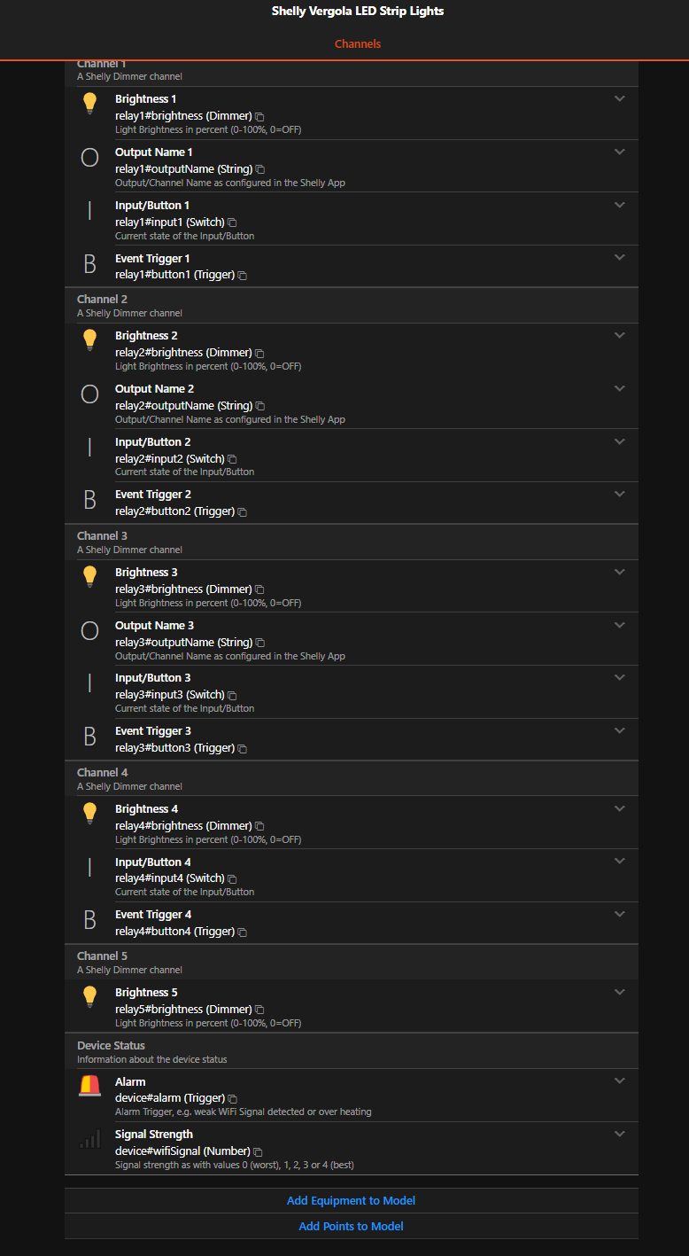

Hi All, it seems the Shelly Pro RGBWW PM is not supported by the binding in OH5.1, does anyone know if its supported in later releases? Thanks

@dastrix80
Not yet, there is a PR, but this requires more work and has low priority

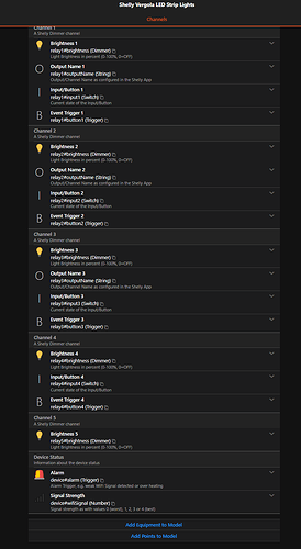

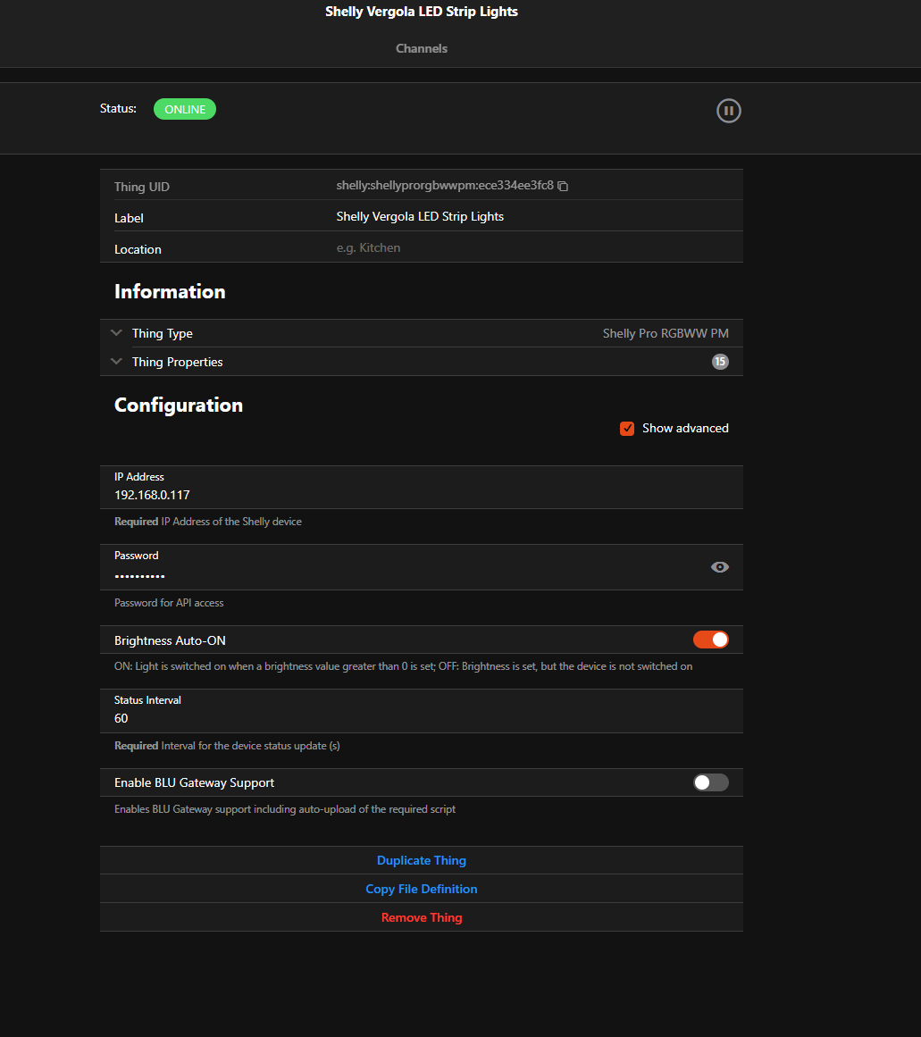

That sucks :frowning:I’m going to give this to Claude and get it to create me a jar with support
@Nadahar What’s so funny?
So far good progress in 30minutes
EDIT: Done, now supported and now working.
:white_check_mark: Part A — Binding now persists
The clean mechanism: I overwrote the jar the Shelly feature resolves from in the persistent maven repo:
/var/lib/openhab/tmp/mvn/…/org.openhab.binding.shelly-5.1.0.jar ← now your custom build
  • shelly stays in the feature list, so the feature keeps providing the californium (CoAP) dependency the binding needs — that was the trap when I briefly removed it (the binding couldn’t resolve and all 6 Shellys dropped; recovered immediately).
  • Applied live via bundle:update+refresh. On any restart, openHAB loads my code whether it reads from the felix cache or re-resolves from maven — both now point at my build.
  • Stock jar saved as *.jar.stock.bak; config backed up as org.openhab.addons.cfg.bak.
One caveat: an openHAB version upgrade will replace that jar with a new stock version, so the custom binding must be re-applied after upgrades (source + built jar are retained on the host for that). All 5 other Shelly devices are unaffected and ONLINE.
:white_check_mark: Part B — 3 white-channel items, linked
│ Item │ Label │ → Channel │ State │
│ Vergola_Channel1 │ Vergola Channel 1 │ relay1#brightness (light:0) │ 100 │
│ Vergola_Channel2 │ Vergola Channel 2 │ relay2#brightness (light:1) │ 0 │
│ Vergola_Channel3 │ Vergola Channel 3 │ relay3#brightness (light:2) │ 0 │
Created as Dimmer items (dimmable white strips; ON/OFF still work in rules) following your Vergola_… naming, category light, tagged Lighting/Point. The distinct states (100/0/0) confirm each item drives its own physical channel. (Channels 4 & 5 exist on the thing but are left unlinked.) Cleaned up the temporary test item/link too.
Two notes:
  • Channel 1 reads 100% — that’s the device’s actual current state (it’s the heavily-used output); I didn’t change any light levels. Let me know if you want it off.
  • I haven’t forced a full openHAB restart to prove persistence (it briefly takes the whole system down). The mechanism is sound, but if you’d like 100% confirmation I can restart openHAB at a moment that suits you and verify the Vergola comes back ONLINE on its own.
