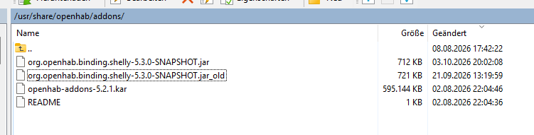

nice work @markus7017 ! Does ist also have the “running on 5.2.x” fix? So I’m able to install it on my production?
The DEV file which is 2h old, is not working for me on my 5.2.1 OH system.
All my Shelly items are offline..
It looks the dev file is smaller than the older dev file.
Please check Markus if it went normal by uploading to github.
Used now my backup with DEV from the 5.3.0.202609201332,. This is working again.
@scheuerer
ok, new it’s 700 ok, please try again
@alaub81 yes, it runs on 5.2.1 and 5.3.x
@markus7017 : Thanks. It’s works.now in priciple with the 5.3.0.202610031857
